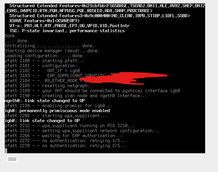

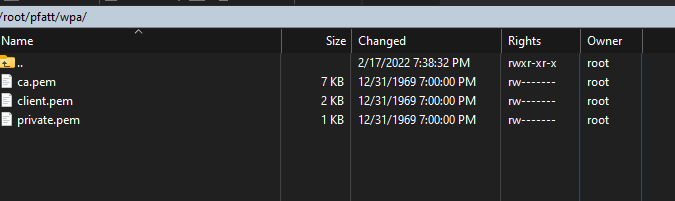

i got the certs out again and now it don't work I cant get pass the
WPA_STATUS_CMD="wpa_cli status | grep 'suppPortStatus' | cut -d= -f2"
IP_STATUS_CMD="ifconfig ngeth0 | grep 'inet\ ' | cut -d' ' -f2"
/usr/bin/logger -st "pfatt" "waiting for EAP authorization..."

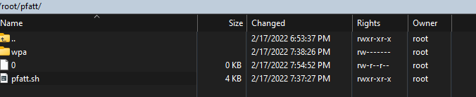

During all this messing. I deleted my cert, so I had to pull again.
=Here is my full script
#!/usr/bin/env sh

/usr/bin/logger -st "pfatt" "starting wpa_supplicant..."
WPA_PARAMS="
set eapol_version 2,
set fast_reauth 1,
ap_scan 0,
add_network,
set_network 0 ca_cert \"/root/pfatt/wpa/ca.pem\",
set_network 0 client_cert \"/root/pfatt/wpa/client.pem\",
set_network 0 eap TLS,

@SGC1990 what folder are your certs in and do they have the appropriate permissions? That script assumes they are in the /root/pfatt/wpa/ directory.
also, are you using igb0?
and the ont is plug in to igb0
This is what happens to mine as well, unable to EAP auth.
also, the script is not making a log any more

I can't directly answer that question, but dmesg can still be used to debug most of the creation stage of the interfaces and net graph flow.
I'm tethered and not having much success. I have applied the patches but I'm not getting a DHCP on ngeth0.
Any ideas?
