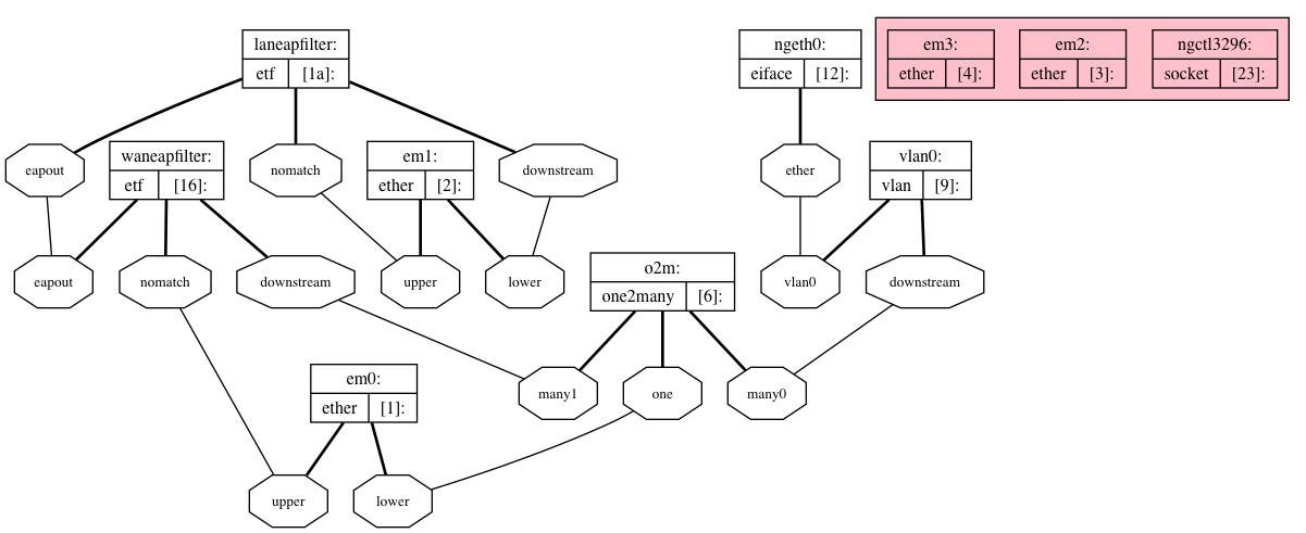

Issue
ngctl list
to verify the netgraph output matches the configuration in the script.
