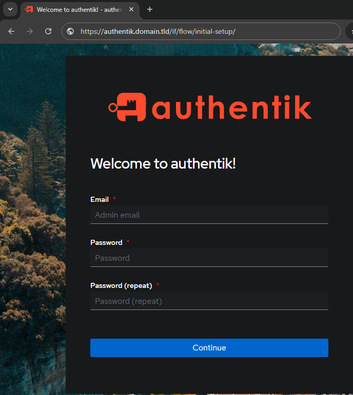

Initial Setup
  1. Navigate to Authentik at https://authentik.domain.tld/if/flow/initial-setup/
  2. Login to Authentik to begin setup.
Note
If this is the first time logging in you will have to set the password for akadmin (default user). If establishing the default credentials fails - the setup is not working correctly.
Authentik-Initial-Setup
The default user is akadmin, which is a super user. This initial setup will setup the Super User's email and Password. You will change the username FROM akadmin to whatever you want.
The first screen you'll see after setting the password and email is:

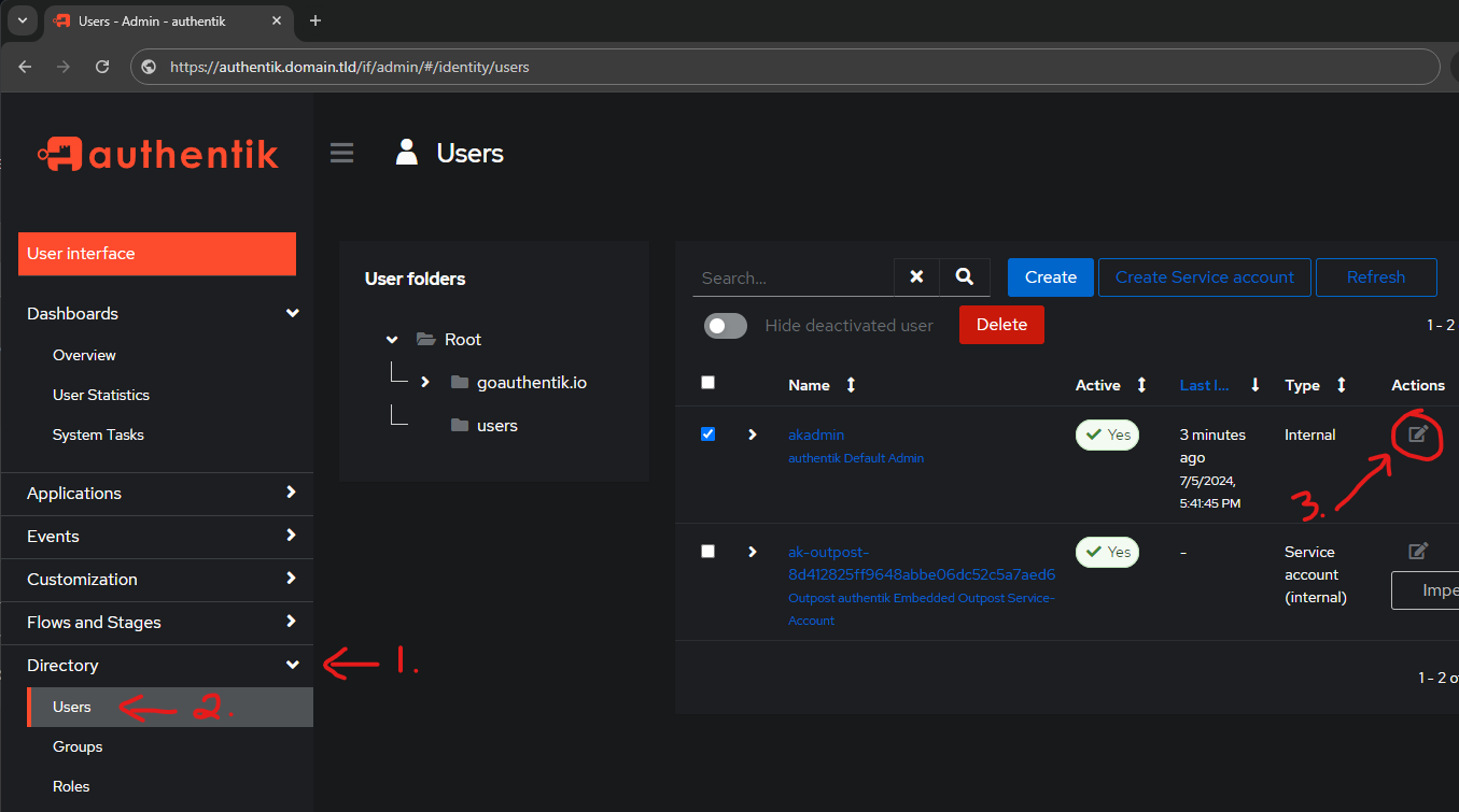

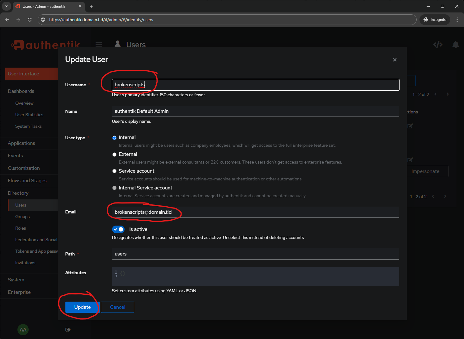

You can change the username from akadmin to whatever.
In the Admin Interface go to
  1. Directory
  2. Users
  3. Click on Edit beside akadmin
edit-admin-name
name-change

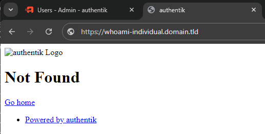

(Information) Error Screen before Provider and Application
I think this is important for anyone that attempts to set this up.
If you attempt to navigate to a page that IS using Authentik's forwardAuth middleware but haven't finished setting up a provider and application (individual or domain wide catch all) then you will see a screen like this:
error-before-setup

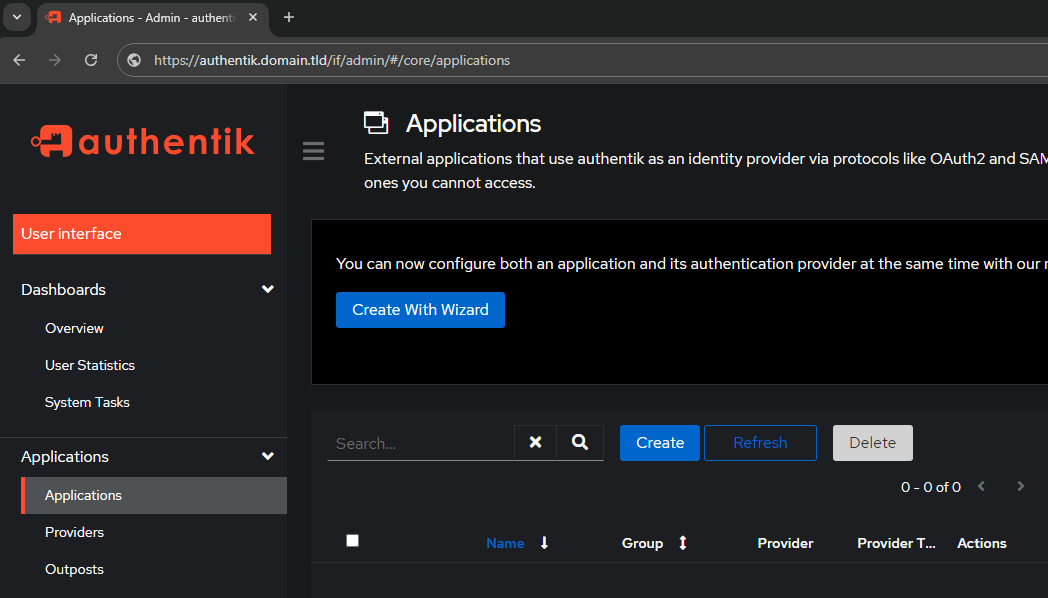

Navigate to:
  1. Applications
  2. Applications

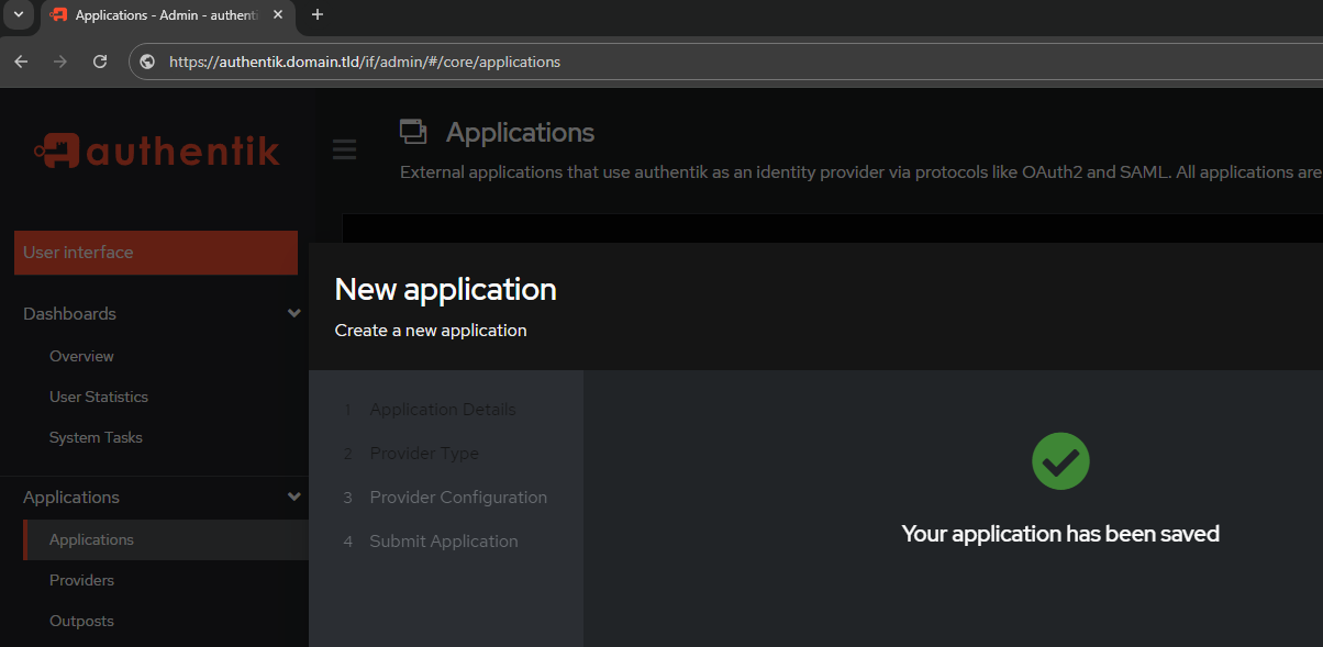

  3. "Create with Wizard"
    app-page

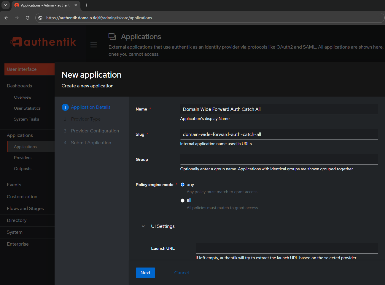

Wizard Page 1 - "Application Details"
  • Name: Domain Wide Forward Auth Catch All
  • Slug: domain-wide-forward-auth-catch-all
  • Group: empty
  • Policy Engine Mode: any
  • UI Settings:
    • Launch URL: empty
    • Open in new tab: unchecked
Catch-All-P1

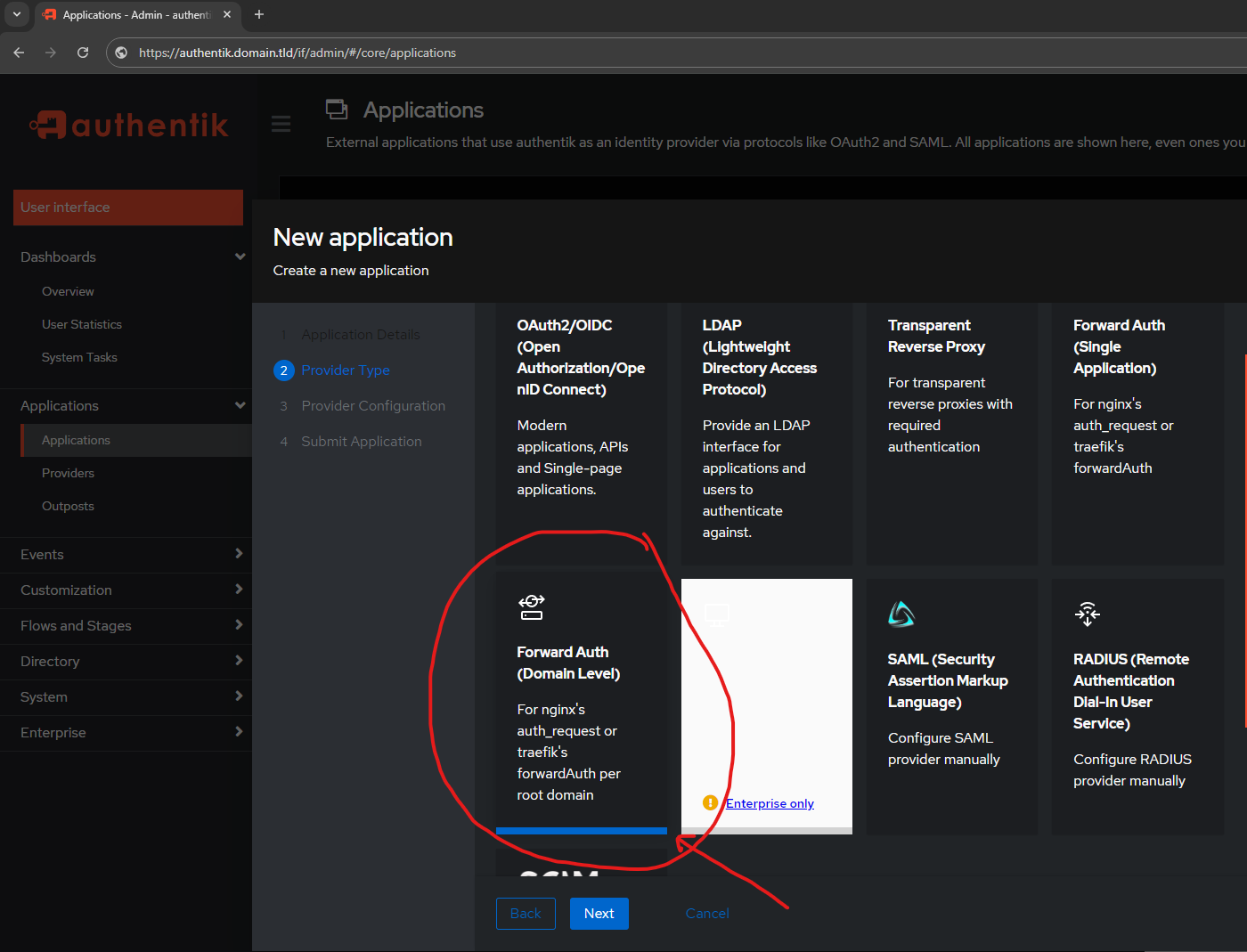

Wizard Page 2 - "Provider Type"
  • Forward Auth (Domain Level)
    Notice the blue highlight underneath showing the selection!
catch-all-p2

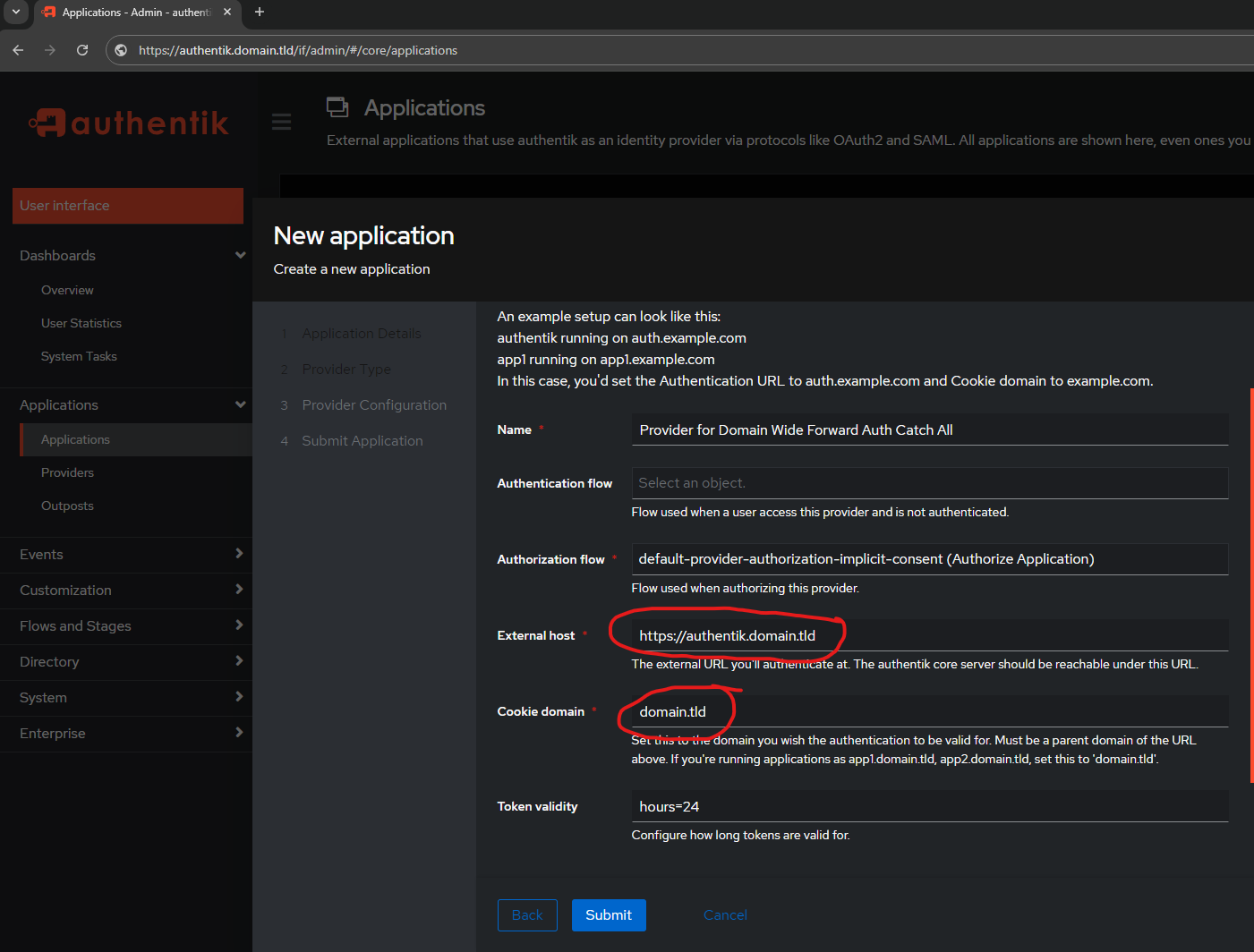

Wizard Page 3 - "Provider Configuration"
  • Name: Provider for Domain Wide Forward Auth Catch All
  • Authentication Flow: empty
    This is user choice, I recommend getting the basics setup and THEN modifying authentication flow for the catch all
  • Authorization Flow: default-provider-authorization-explicit-consent (Authorize Application)
    Explicit requires user interaction aka clicking a button to continue versus implicit which is just trust
  • External Host: https://authentik.domain.tld
  • Cookie Domain: domain.tld
  • Token Validity: hours=24
    catch-all-p3
When all is done, you should have success. If not, carefully review the previous settings. You most likely forgot https:// in front of authentik.domain.tld
wizard-success

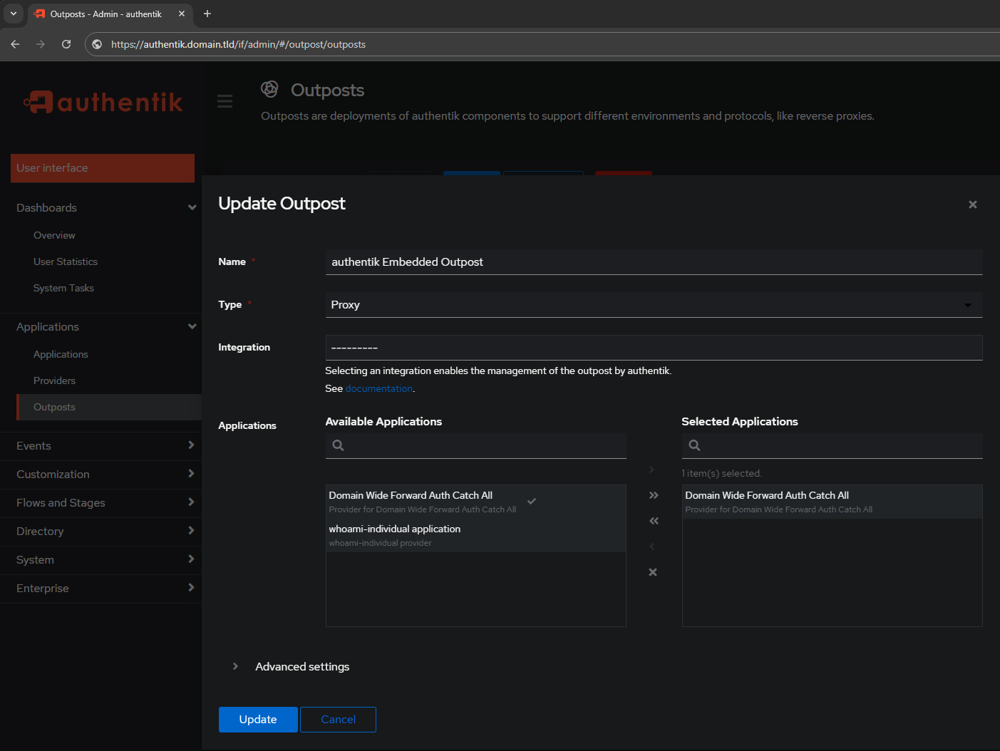

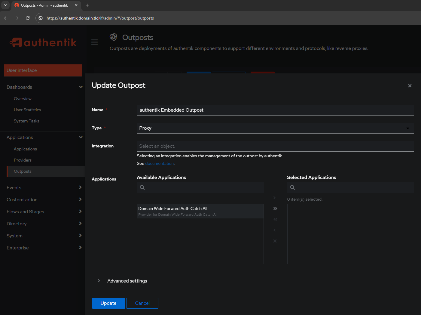

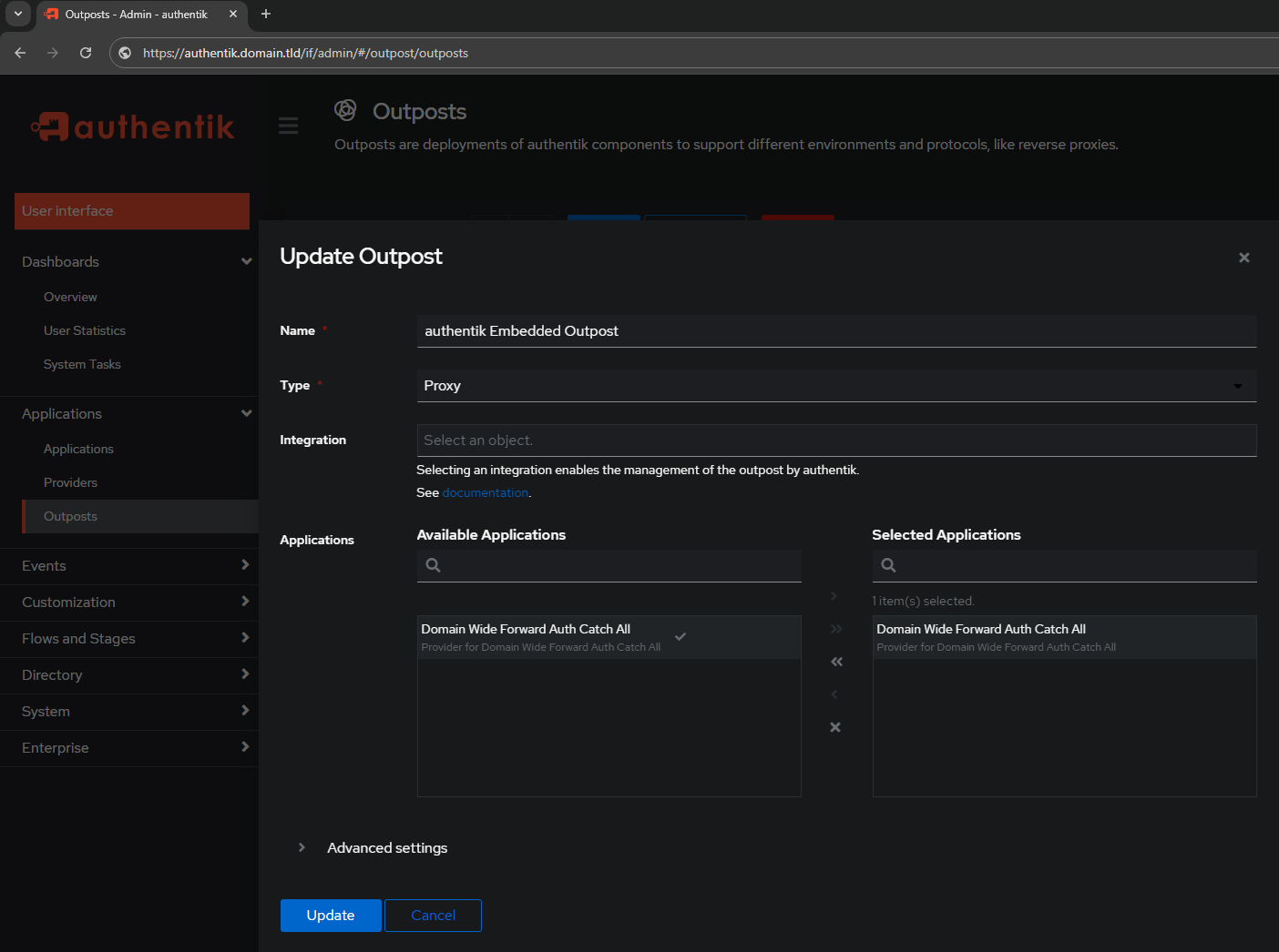

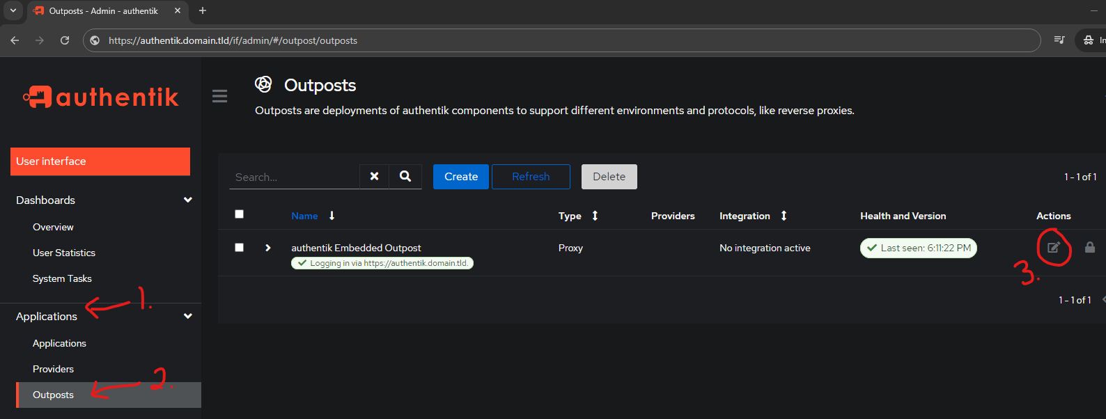

Embedded Outpost (Domain Wide)

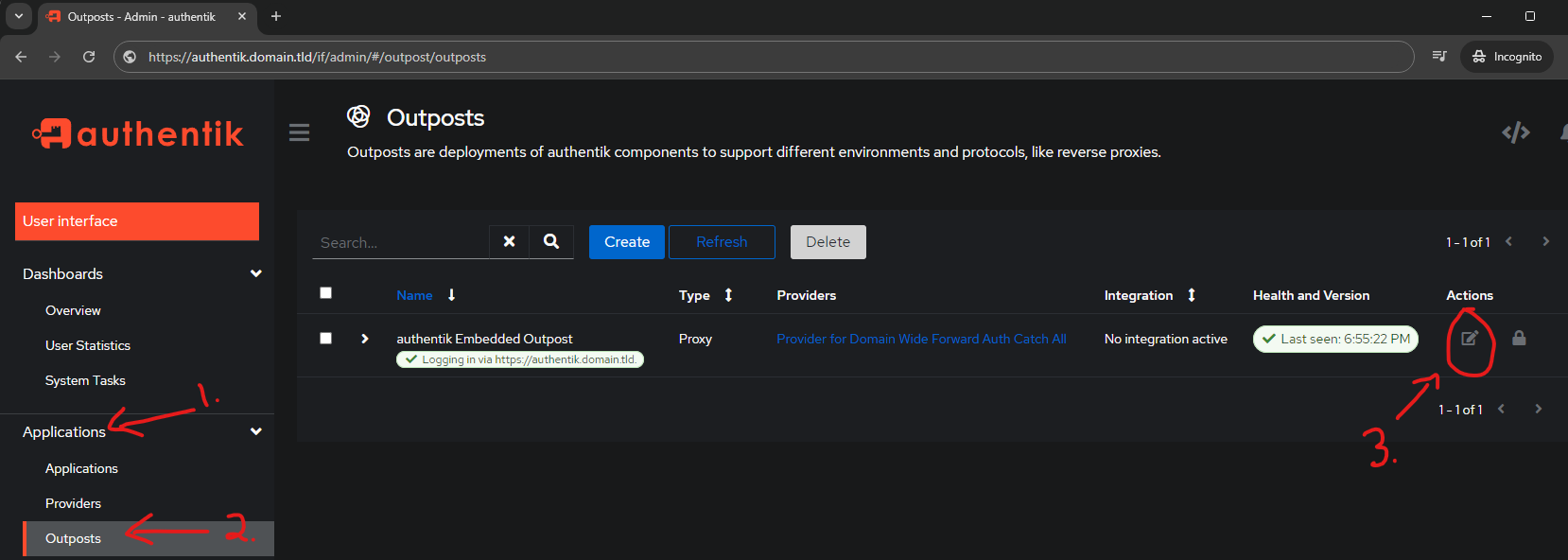

Navigate to the Outposts screen and edit the Embedded Outpost:
  1. Applications
  2. Outposts
  3. Edit the Embedded Outpost
edit-embed
Notice how the above picture has Providers empty?
Update the Outpost to have the Domain Wide Forward Auth Catch All in Selected Applications
BEFORE Adding
before-add
AFTER Adding
after-add

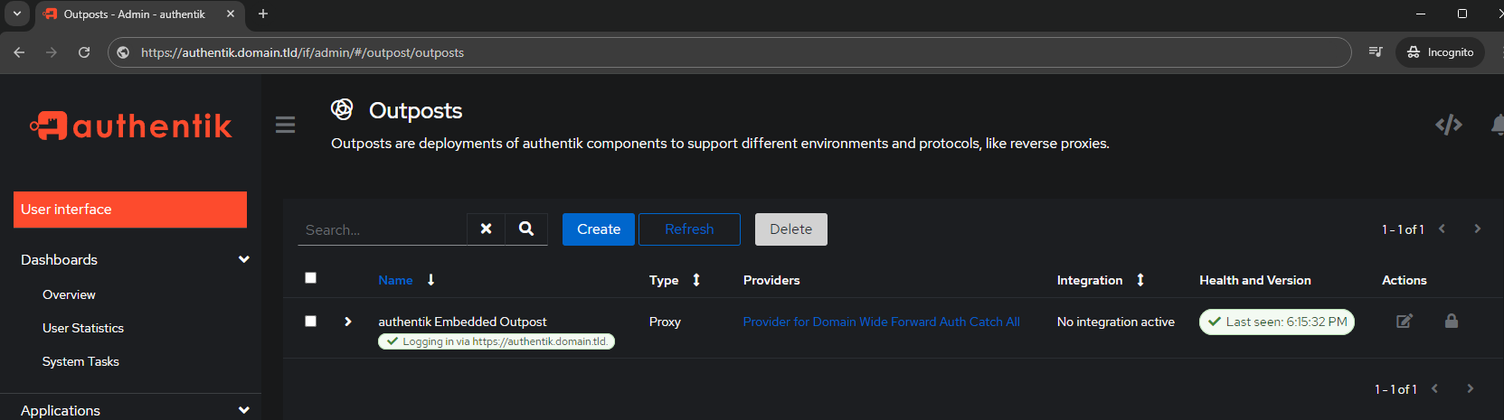

Now the Embedded Outpost shows the Provider for the Catch All rule instead of it being empty/blank:
updated-provider

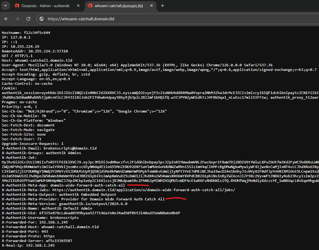

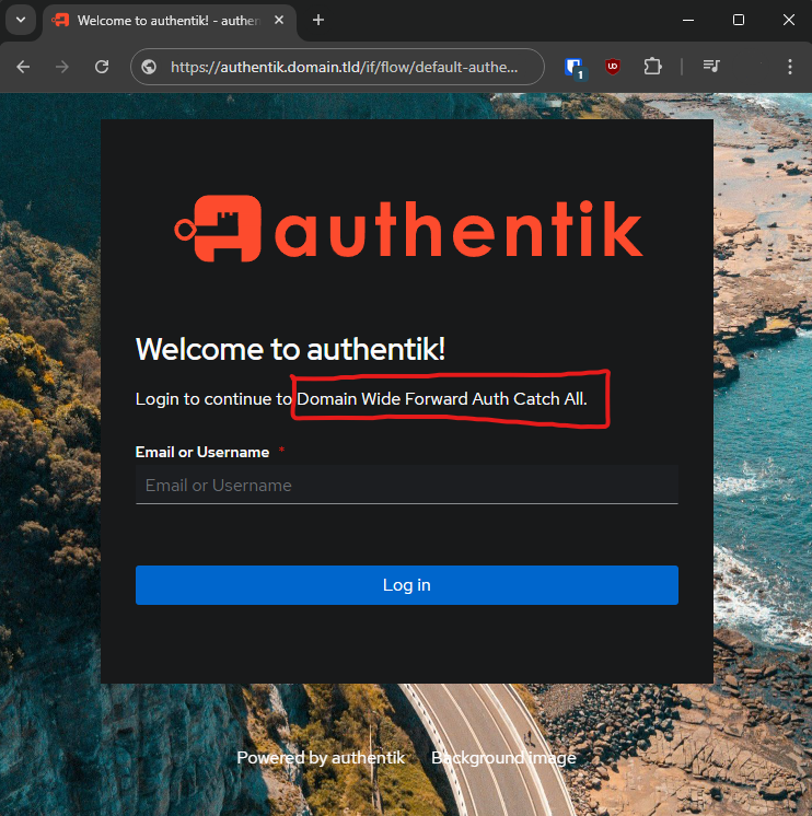

Domain Wide / Catch All Test/Validation
Now that the catch all rule is in place, validate it using the already running whoami-catchall container created:
Navigate to whoami-catchall.domain.tld and it will immediately redirect you to Authentik to login:
fa-splash
whoami-all
X-Authentik-Meta-App: domain-wide-forward-auth-catch-all

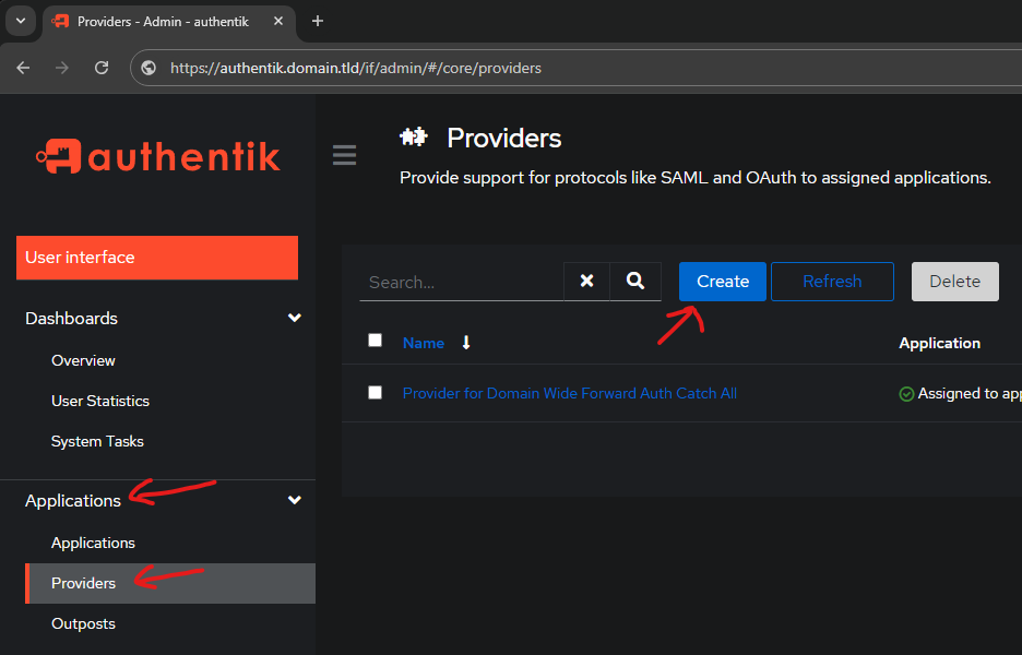

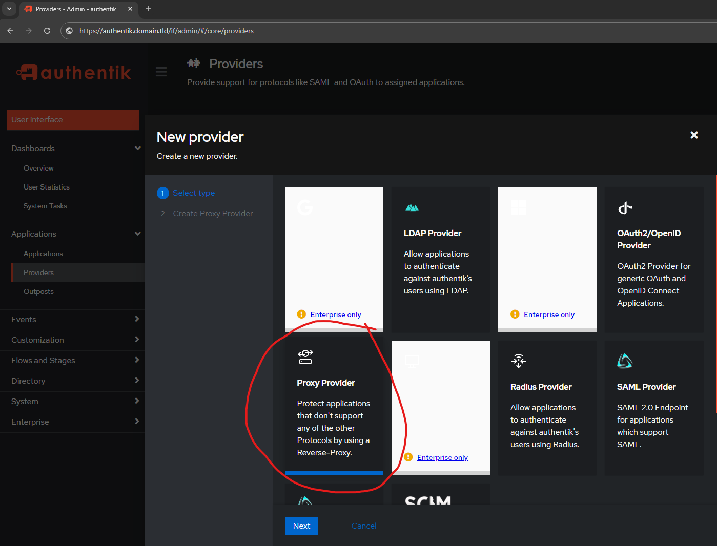

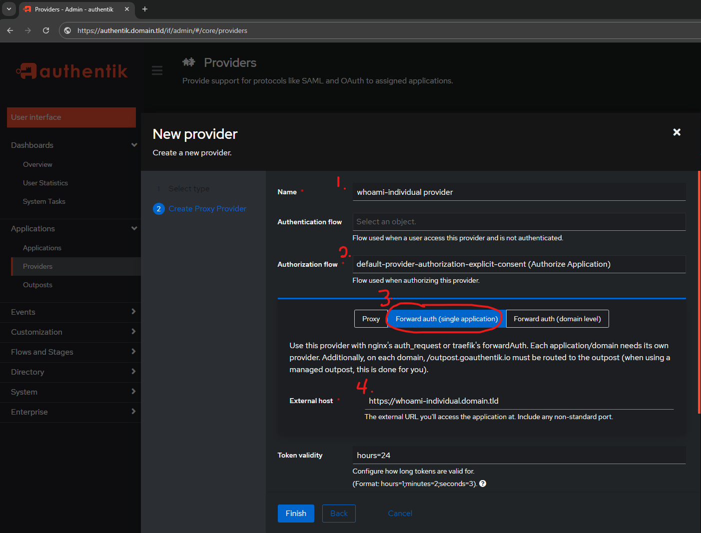

Provider Creation (Individual Application) - Manual
In the Admin Interface, go to:
2. Applications
3. Providers
4. Create
manual-create-p
Select Proxy Provider
m-pp
Use the following settings:
  • Name: whoami-individual provider
  • Type: Forward auth (single application)
    Single Application is where we change it up!
  • External Host: https://whoami-individual.domain.tld
    m-pp-settings

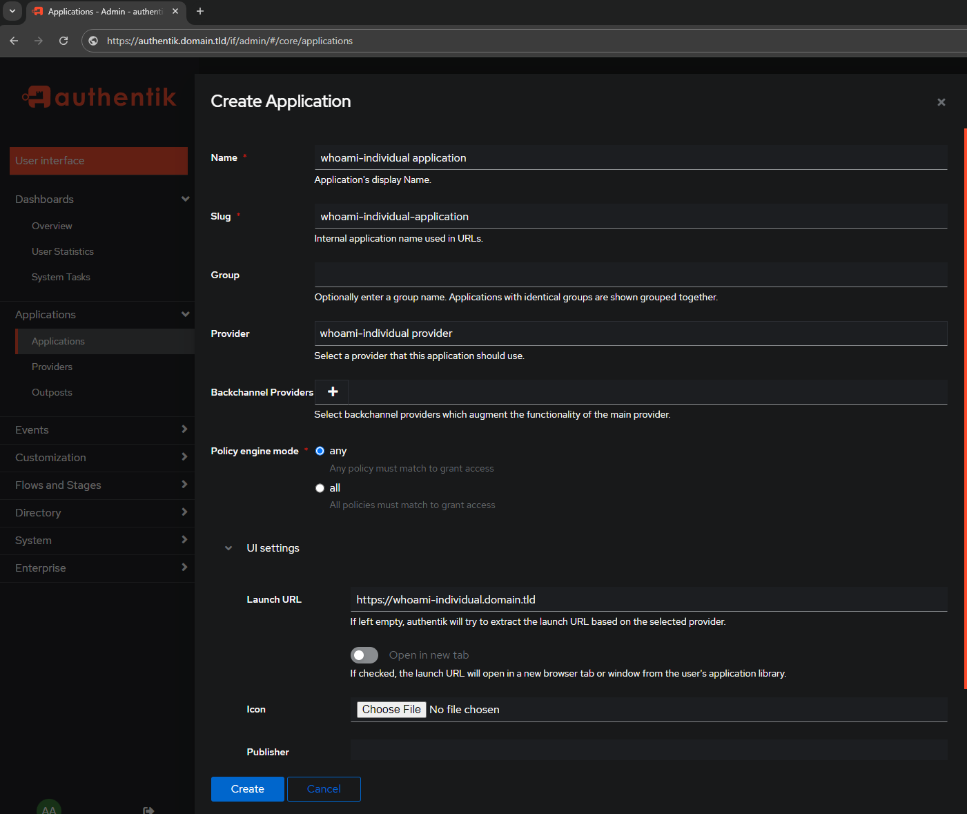

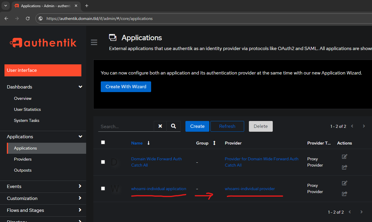

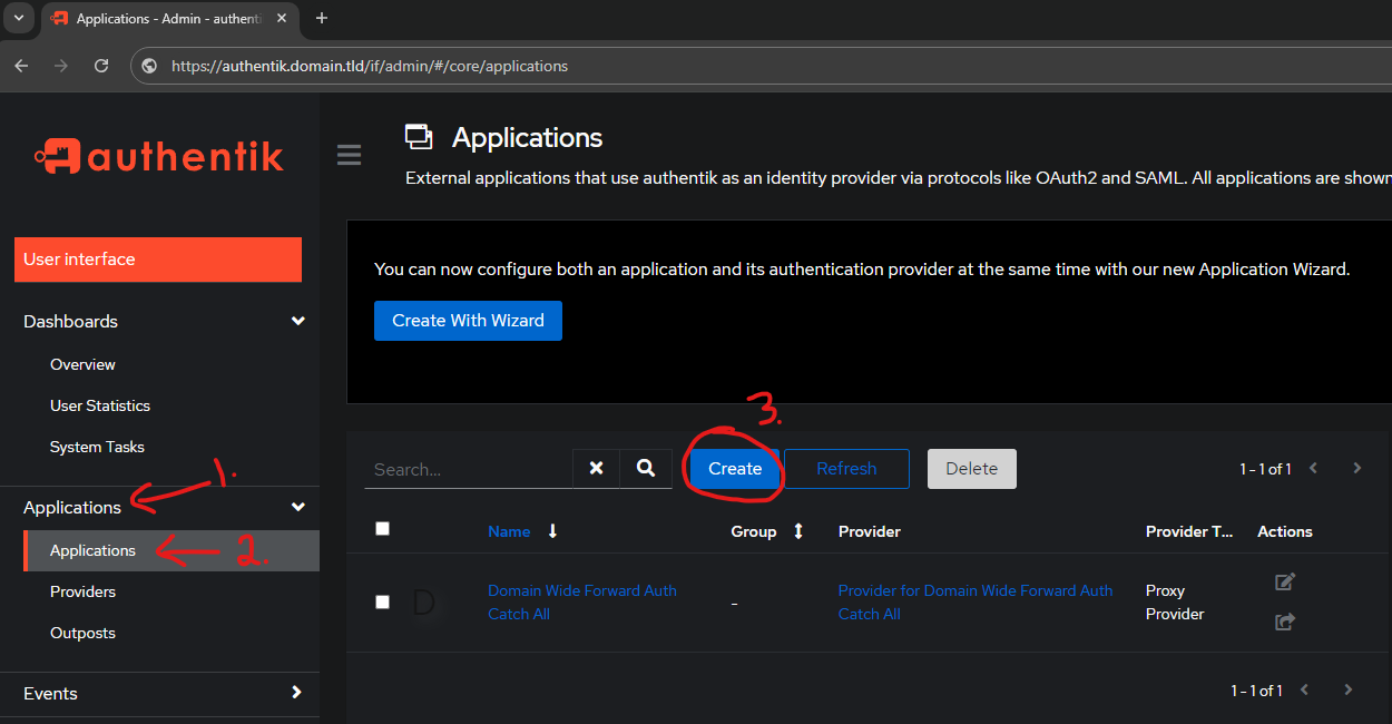

Application Creation (Individual Application) - Manual
  1. Applications
  2. Applications
  3. Create
m-app
  • Name: whoami-individual application
  • Slug: whoami-individual-application
  • Group: empty
  • Provider: whoami-individual provider
    This is where you bind it to the previously created provider!
  • Backchannel Providers: empty
  • UI Settings
    • Launch URL: https://whoami-individual.domain.tld
      Since this is an individual application, specify where it is found at
Manual-App-Create
Manual-App-Bound

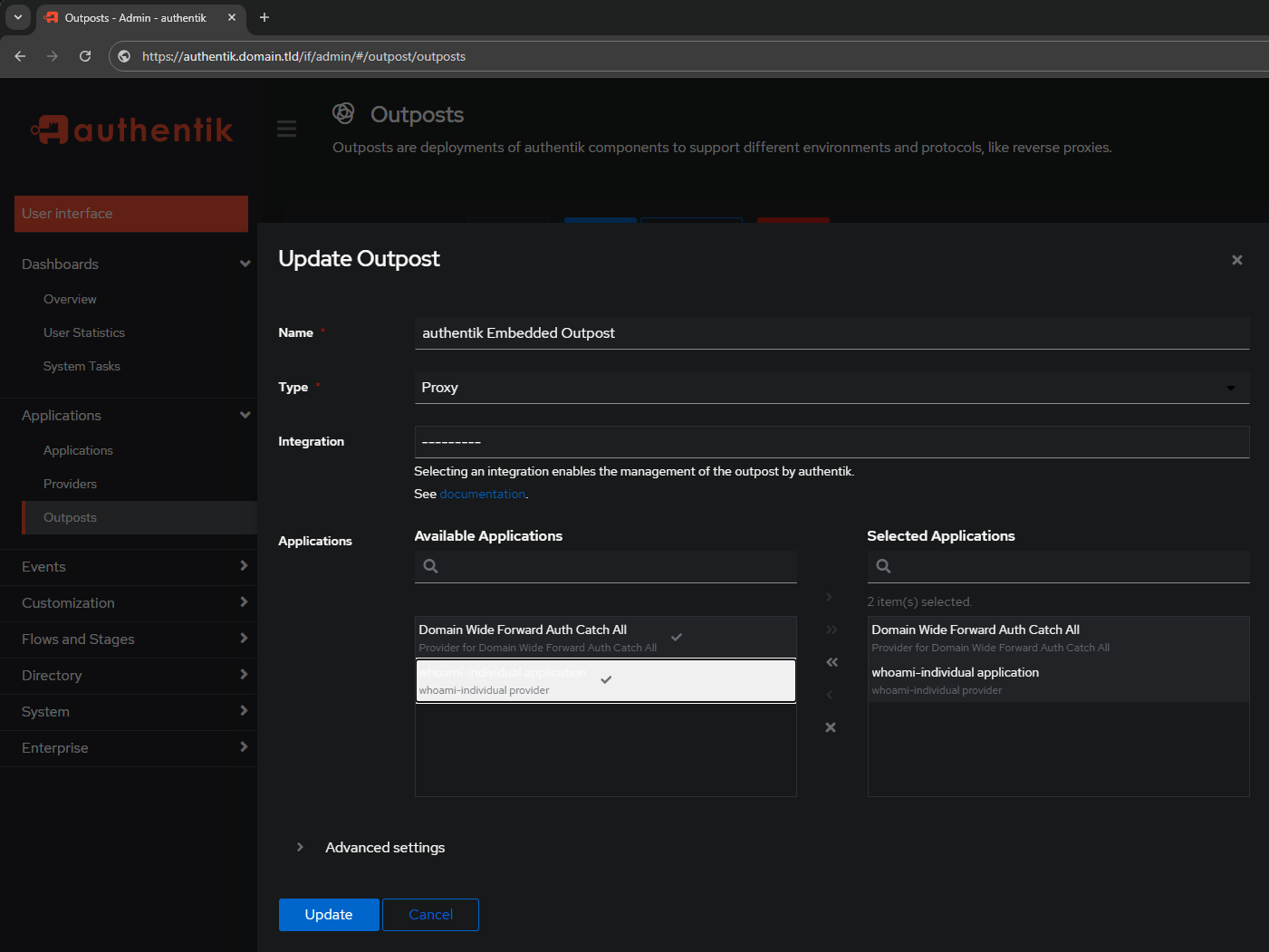

embed-outpost-2
Highlight any application you want the outpost to be able to provide for. In this case Highlight whoami-individual application
BEFORE HIGHLIGHT
Notice that BEFORE highlighting and adding to Selected Applications, it still has only the Domain Wide Forward Auth Catch All rule in Selected Applications:
before-add-2nd
AFTER HIGHLIGHT
after-add-2nd

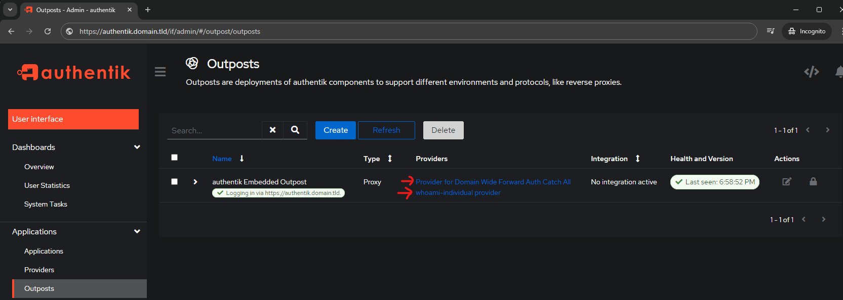

After hitting Update the Outpost page will show that the embedded outpost now has both providers bound to it:
outpost-with-2

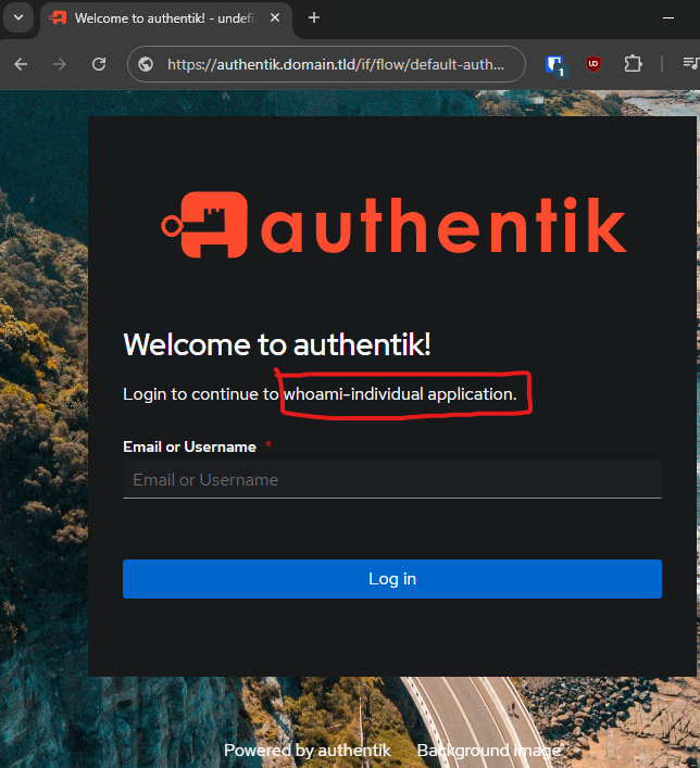

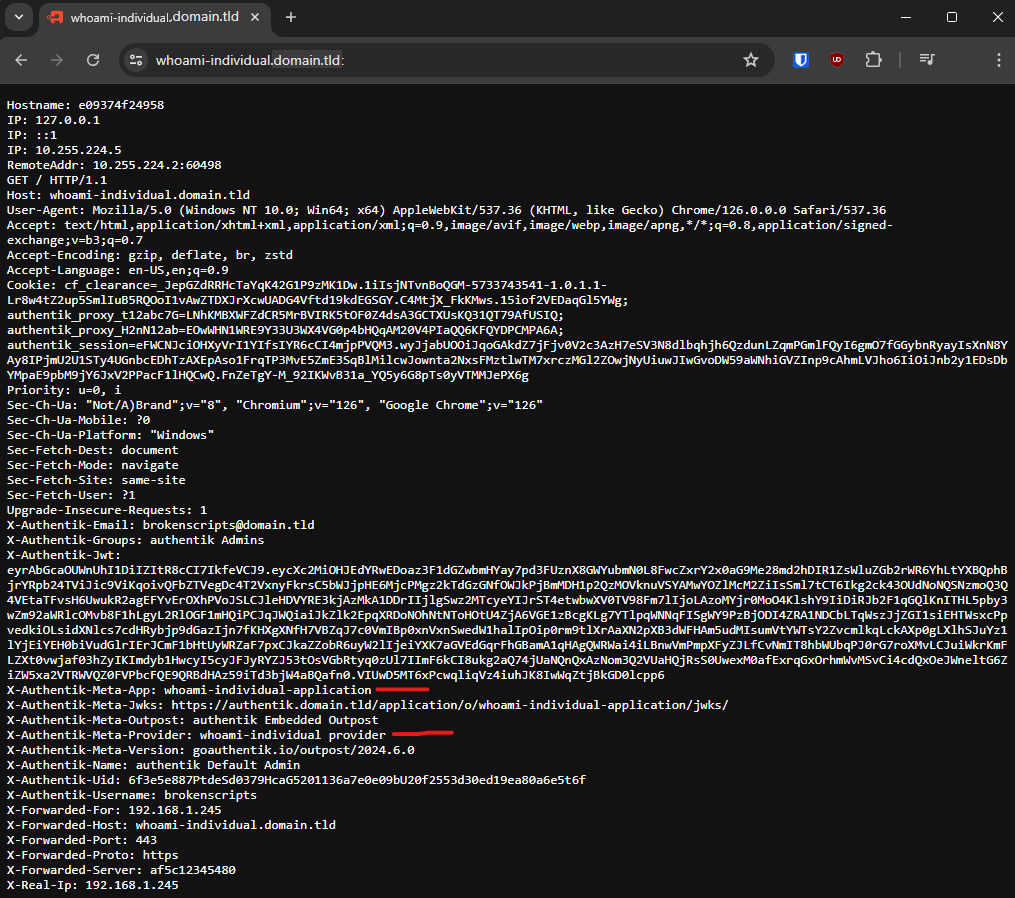

Individual Application Test/Validation
Now that the individual application rule is in place, validate it using the already running whoami-individual container created:
Navigate to whoami-individual.domain.tld and it will immediately redirect you to Authentik to login:
fa-splash
whoami-all
X-Authentik-Meta-App: whoami-individual-application

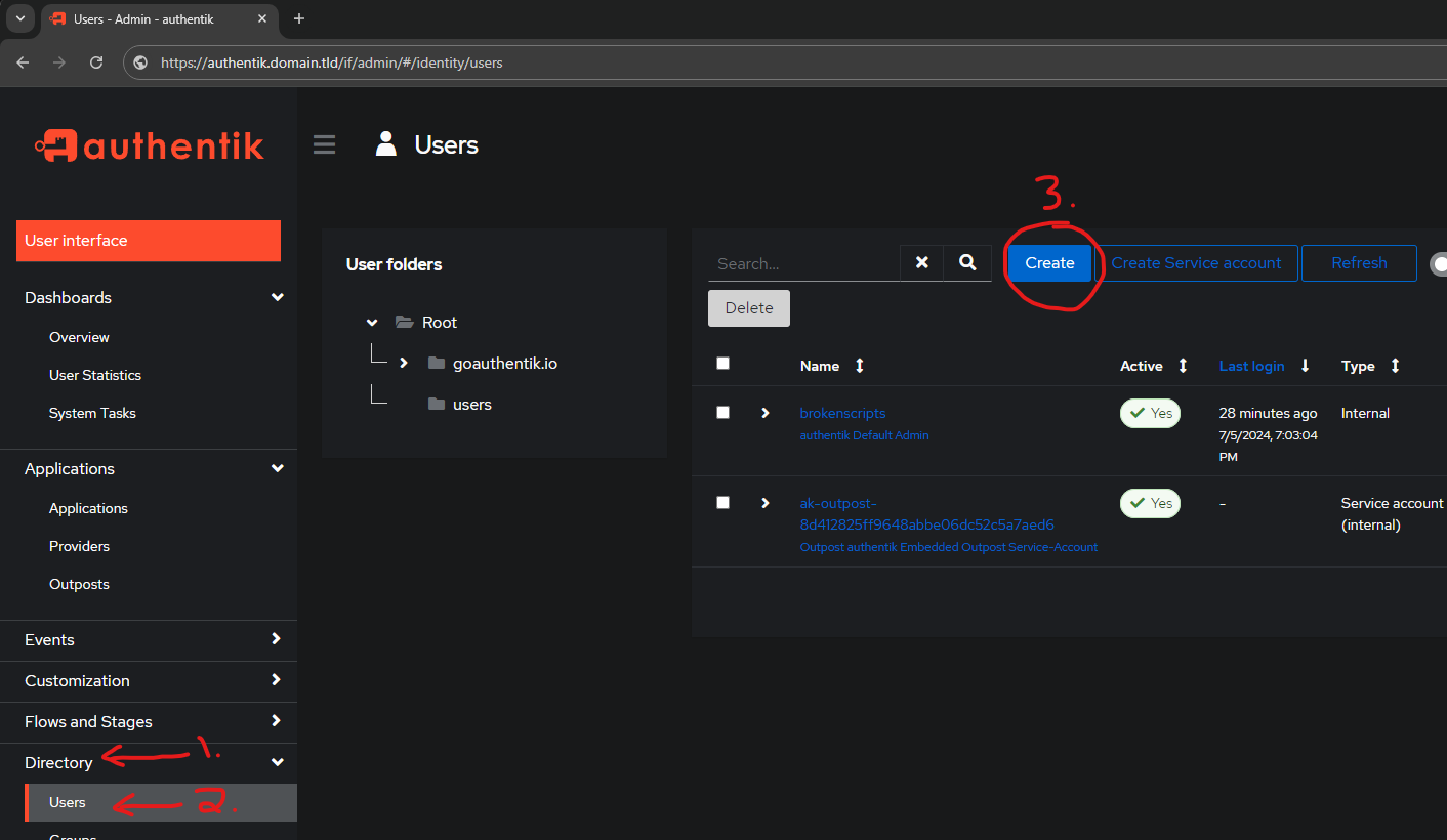

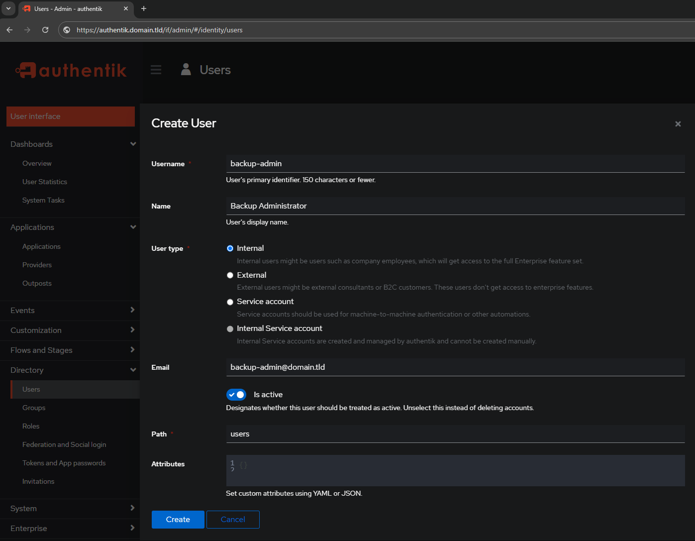

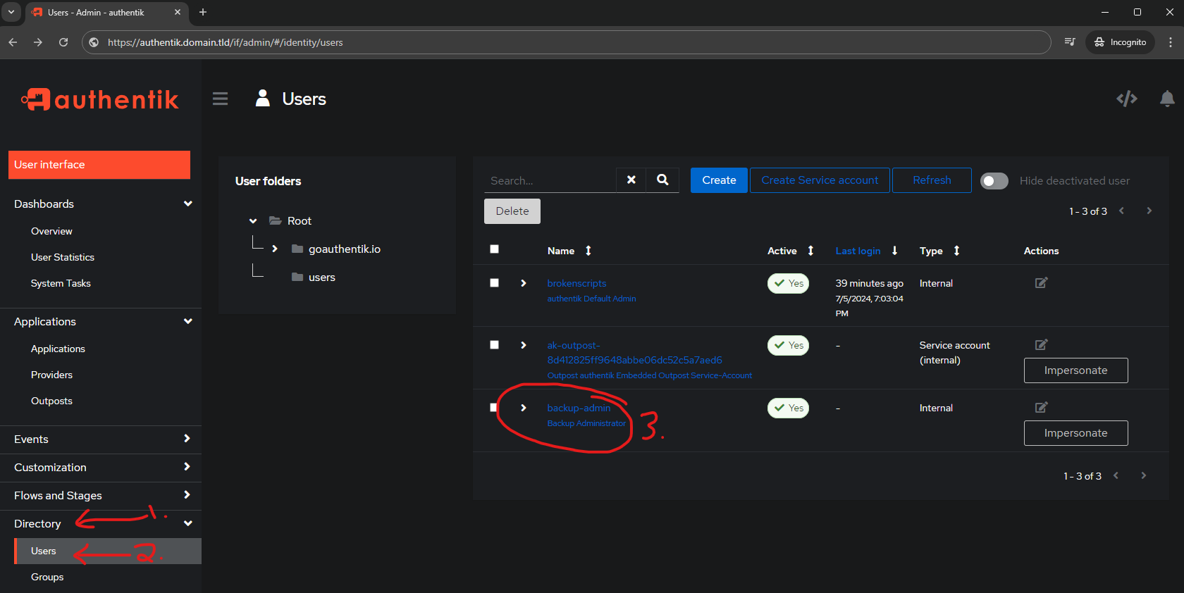

(Optional) New User Creation
  1. Directory
  2. Users
  3. Create
user-create-1
Fill in the required information:
account-create-info

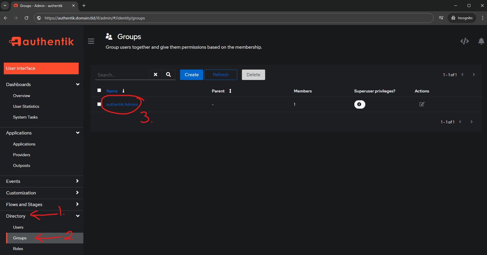

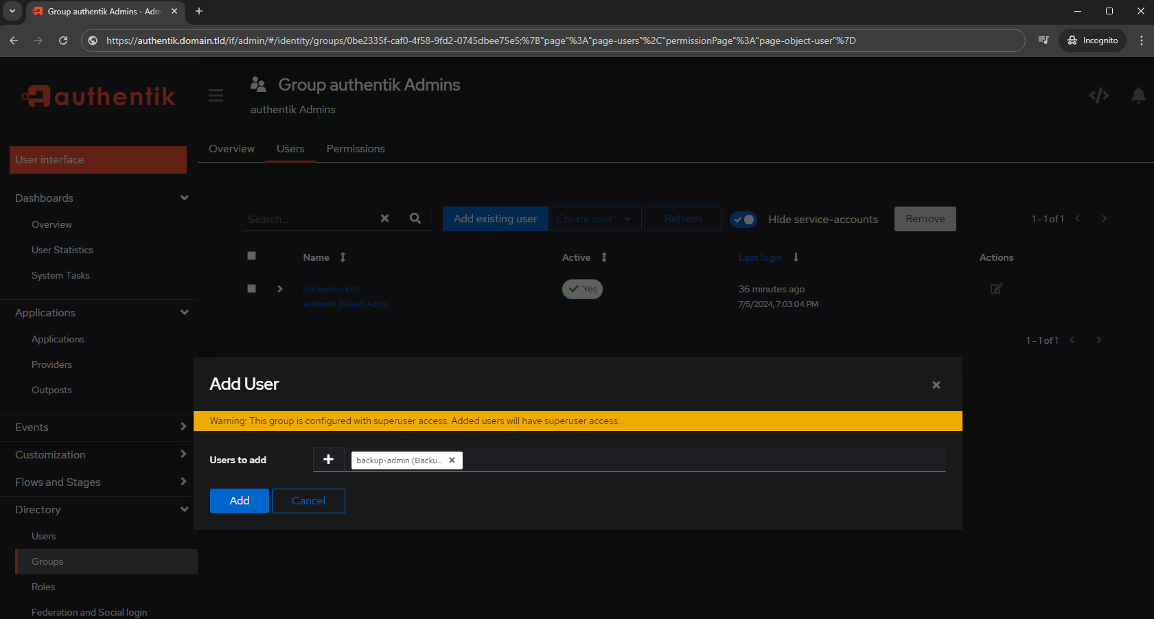

(Optional) Add user to Administrator/Superuser Group
Inside the Admin Interface do the following steps to add a user to the Admins group:
  1. Directory
  2. Groups
  3. Left click/Open authentik Admins
admins-open

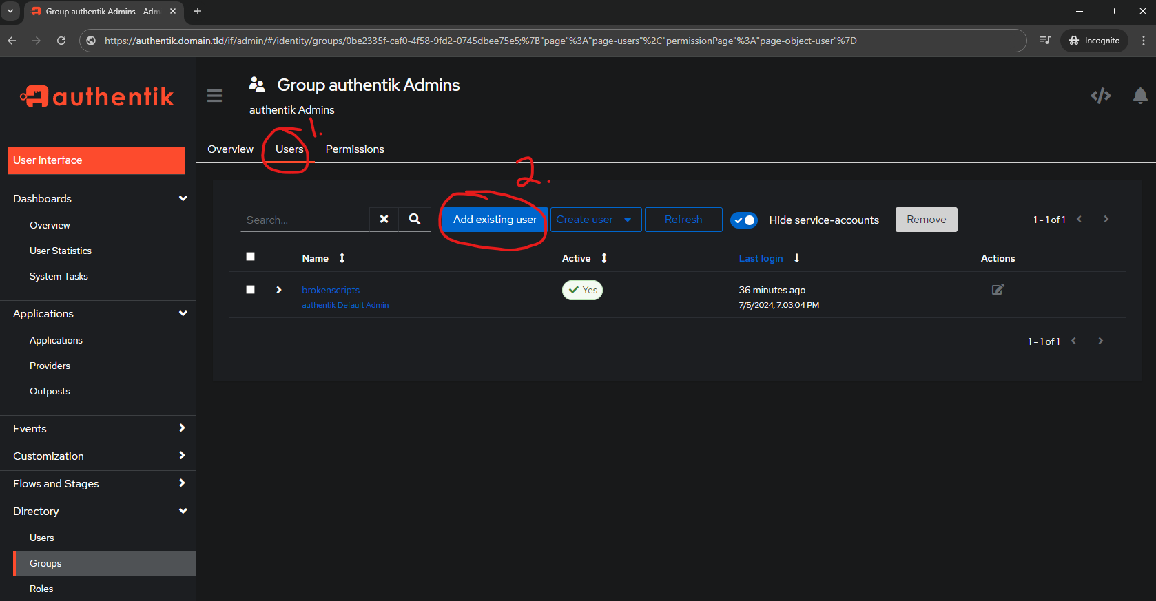

Next, add an existing user to the Users tab:
  1. Users
  2. Add existing user
add-existing-user1
Add the user user-added

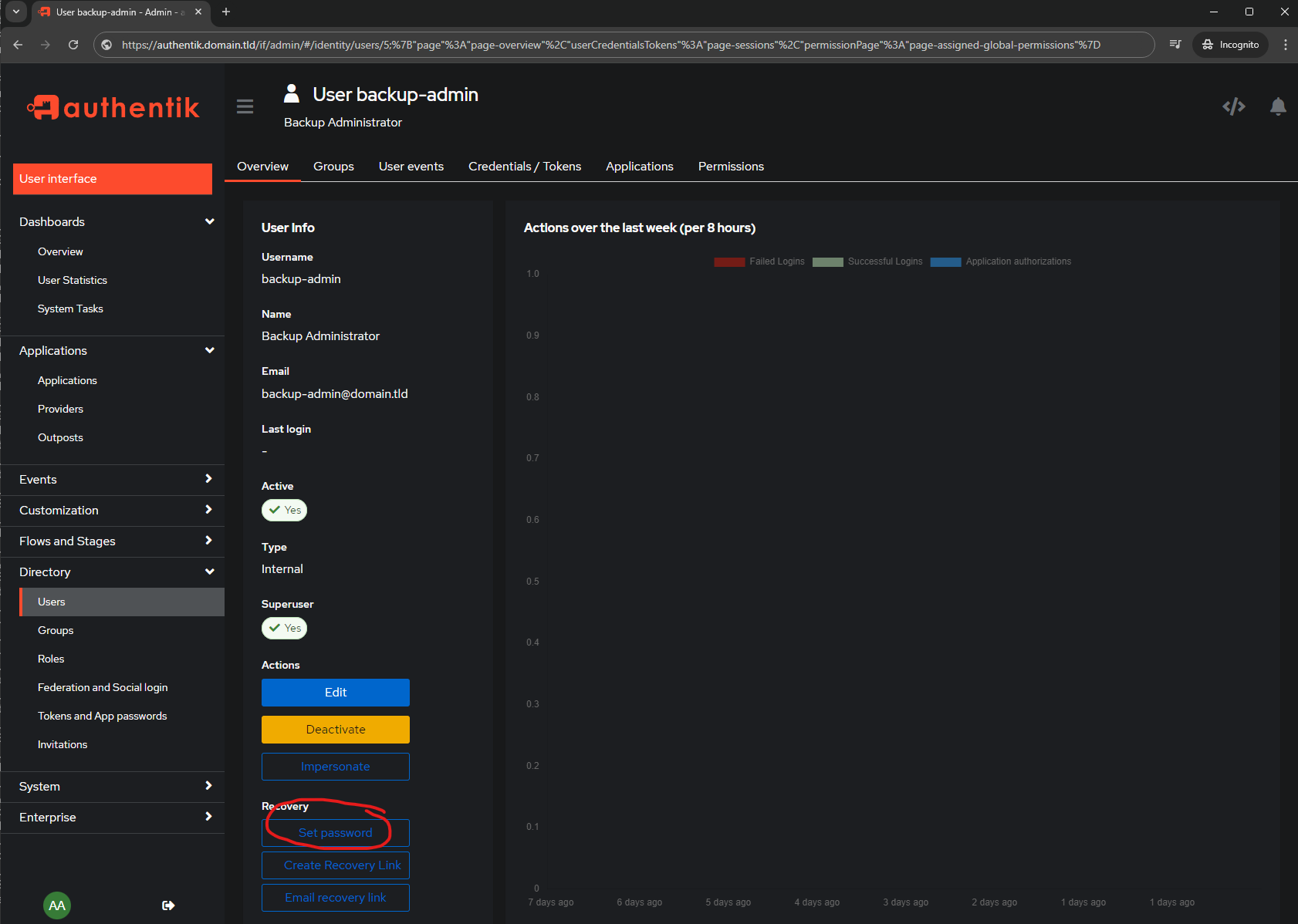

(Optional) Change user password
Inside the Admin Interface do the following:
  1. Directory
  2. Users
  3. Left click/Open the specific user
open-user
set-pw

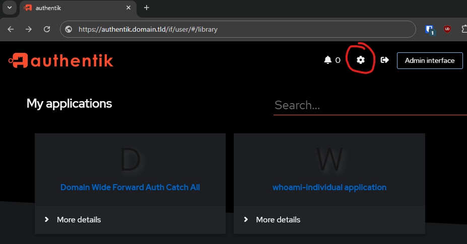

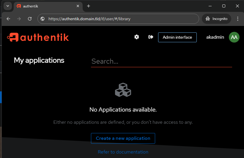

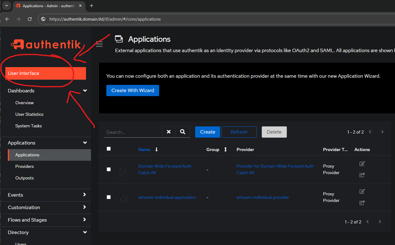

IF you are in the Admin Interface navigate to the User Interface via the button at the top left:
user_interface_button

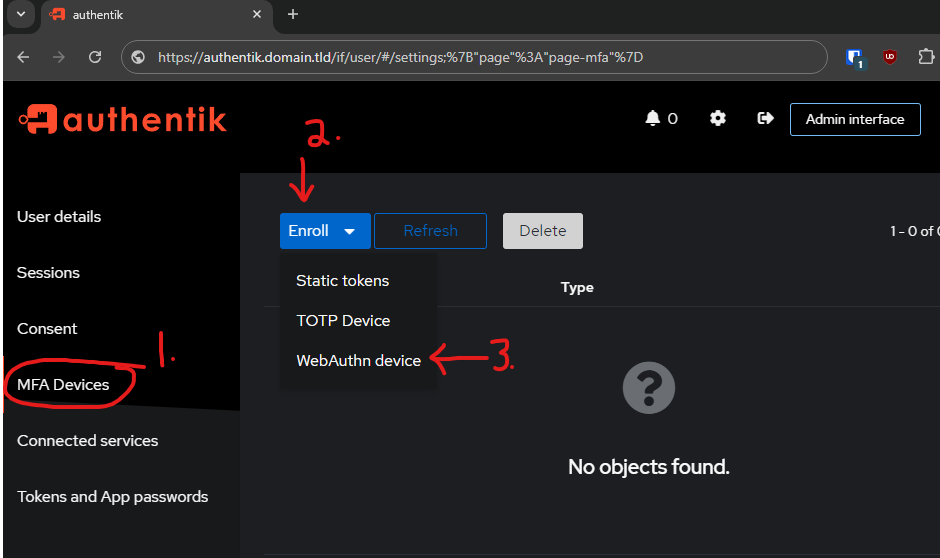

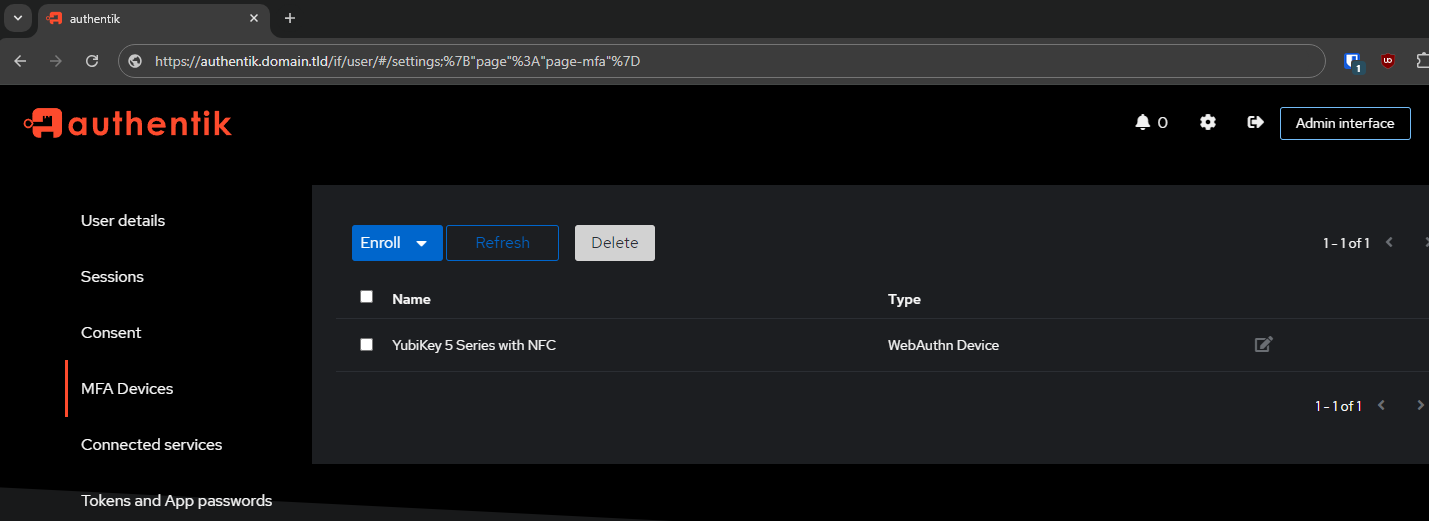

Navigate to the MFA Devices screen:
  1. Settings
  2. MFA Devices
  3. Enroll
  4. WebAuthn device
settings-cog

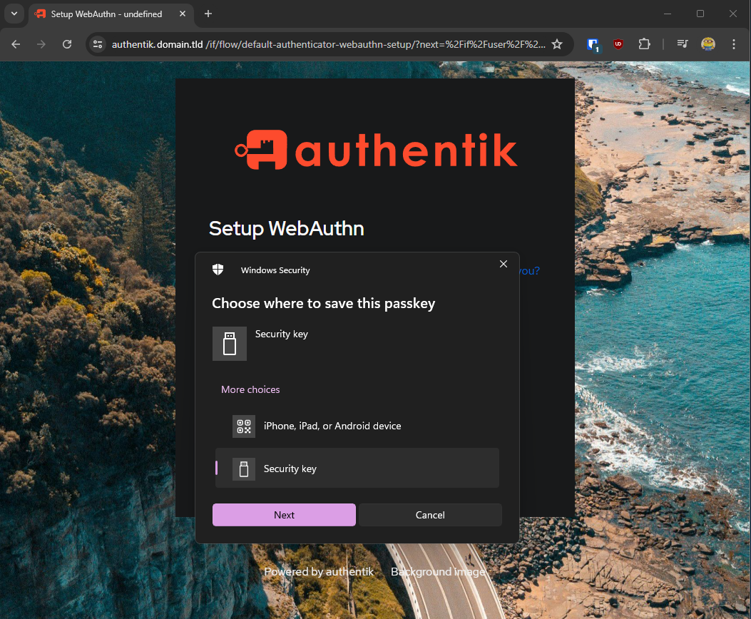

Enrollment with Credential on Key
mfa-dev

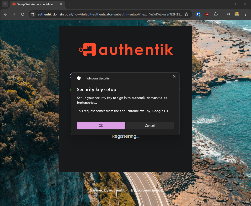

During setup process, depending on your WebAuthn settings you might get prompted for a PIN: webauthn-pin
Now complete the WebAuthn Setup:
webauthn1
Hit next and you'll see that you are about to setup your key:
webauthn2
choose-path

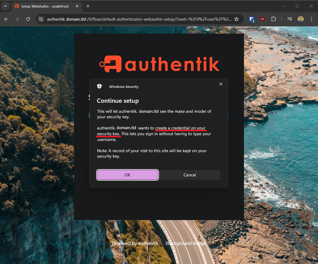

Caution
By performing the setup like this, it asks to create a credential on the Yubikey device itself. If you want to make it where it does NOT create the credential itself skip setup for now and go to the Modify WebAuthn Credential Creation Location section where I will show how to change the save credential to key option. After changing that option, you can revisit setup.
STOP - Read the Above Caution Statement before continuing!
If you're ok with creating the credential on your key, continue!

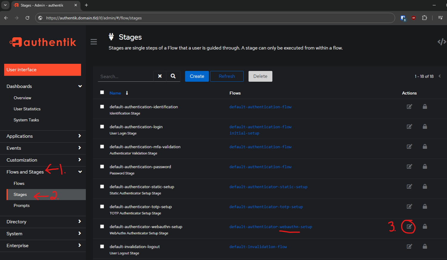

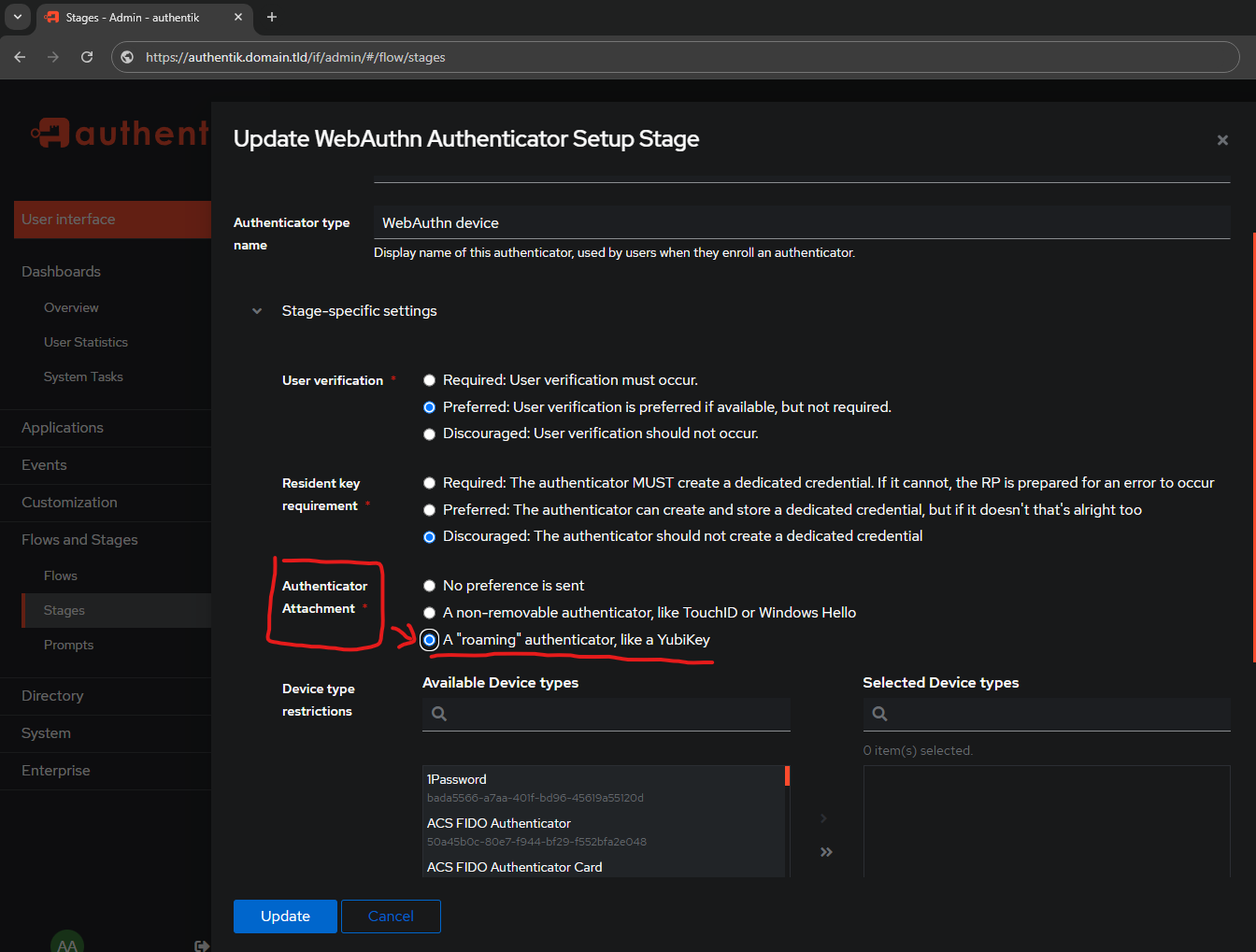

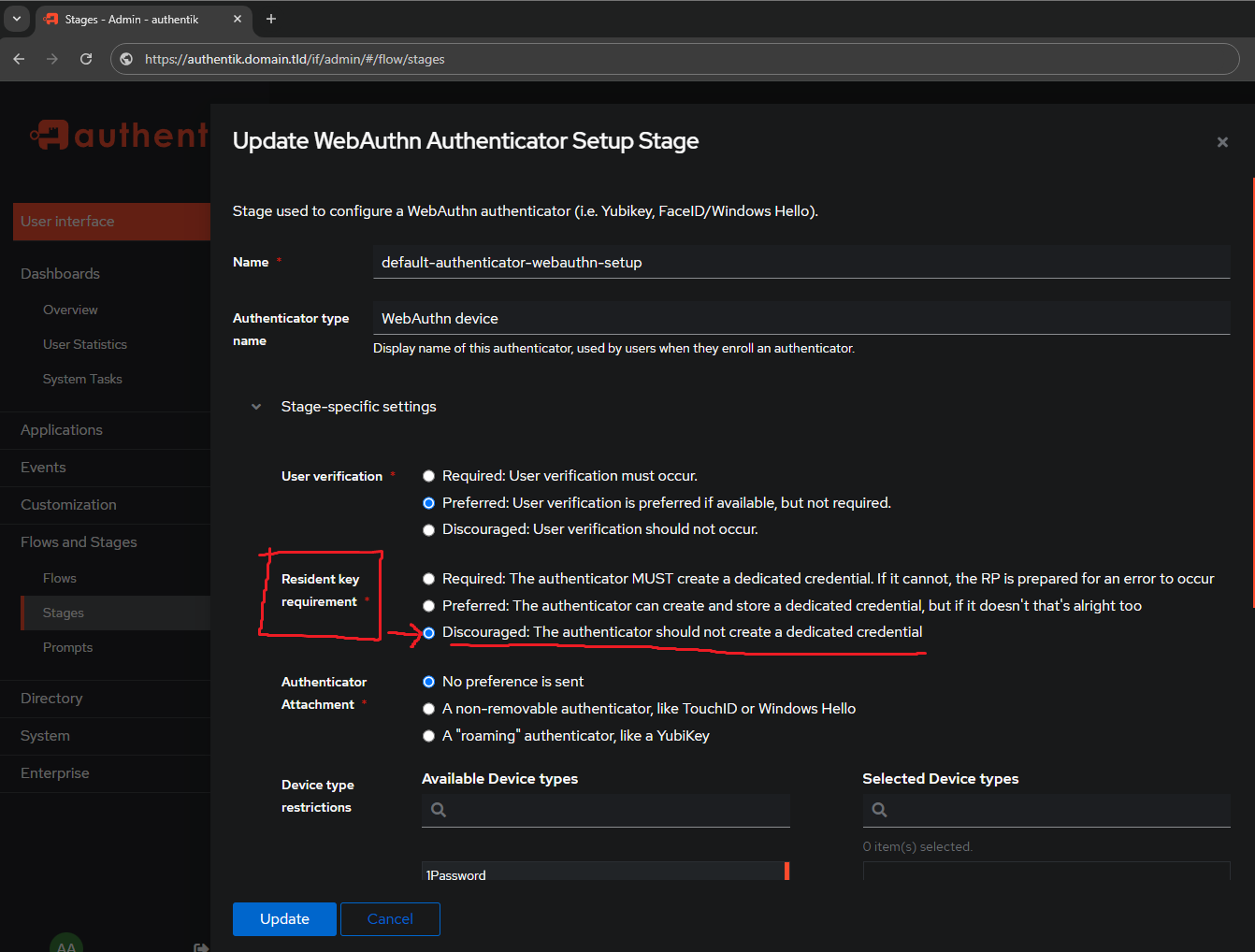

  1. Go to the Admin Interface
  2. Flows and Stages
  3. Stages
  4. Edit default-authenticator-webauthn-setup
edit-webauthn

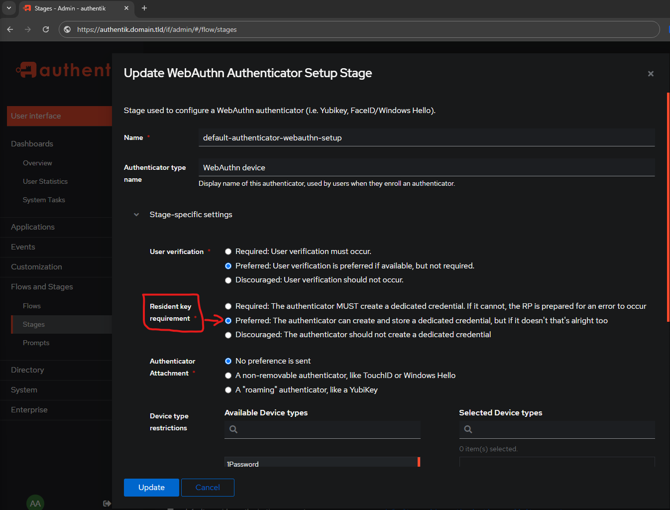

Review the default settings:
res-key-def
Edit the Resident key requirement
  • Default: Preferred: The authenticator can create and store a dedicated credential, but if it doesn't that's alright too
Unfortunately, if I try to skip the dedicated credential, I am unable to setup a Yubikey. I am going to set this option to:
  • Modified: Discouraged: The authenticator should not create a dedicated credential
res-key-change
(Optional) Edit the User verification depending on your WebAuthn expertise.
I am leaving it default:
  • Default: Preferred: User verification is preferred if available, but not required
(Optional) Authenticator preference
Authentik by default has no preference set for the Authenticator, as shown in the above picture. This can be changed to be explicitly Yubikey OR Windows Hello/TouchID. If you do not want to be prompted by Windows Hello, as shown in the Windows Hello section, then set this to A "roaming" authenticator, like a YubiKey.
yubi-pref

(Troubleshooting) Windows Hello
win-hello
Press ESC to continue to actual Yubikey enrollment. This only seems to happen if you have previously setup Windows Hello.

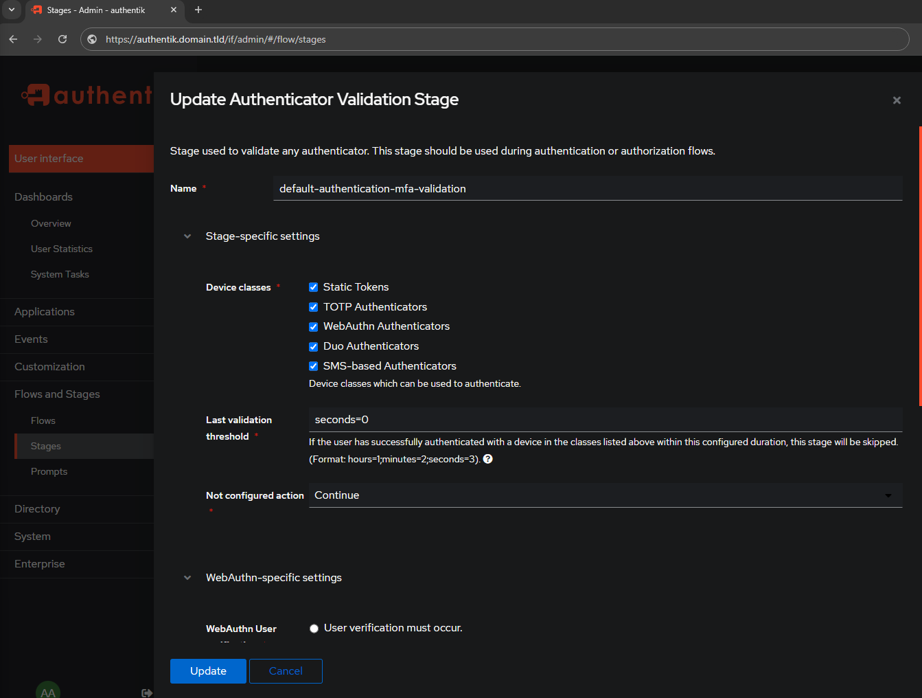

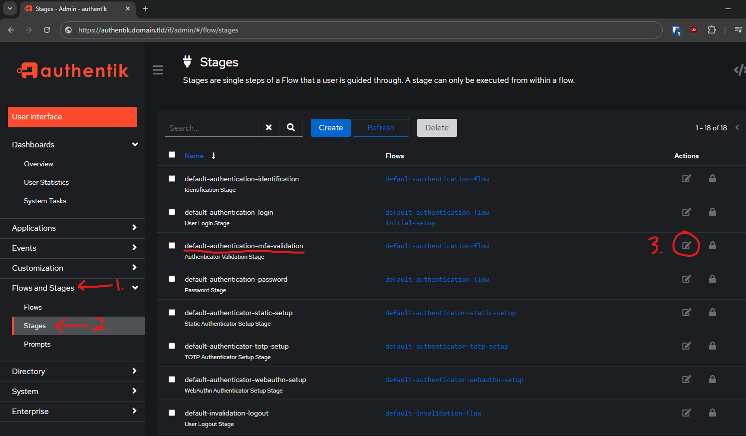

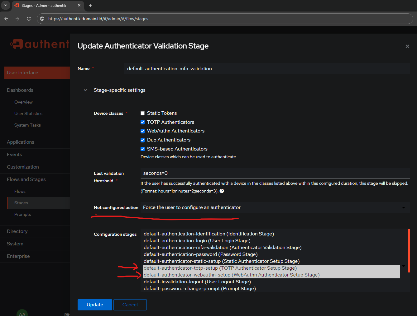

(Optional) Force Multi-Factor Authentication (MFA)
  2. Flows & Stages
  3. Stages
  4. Edit default-authentication-mfa-validation
default-mfa

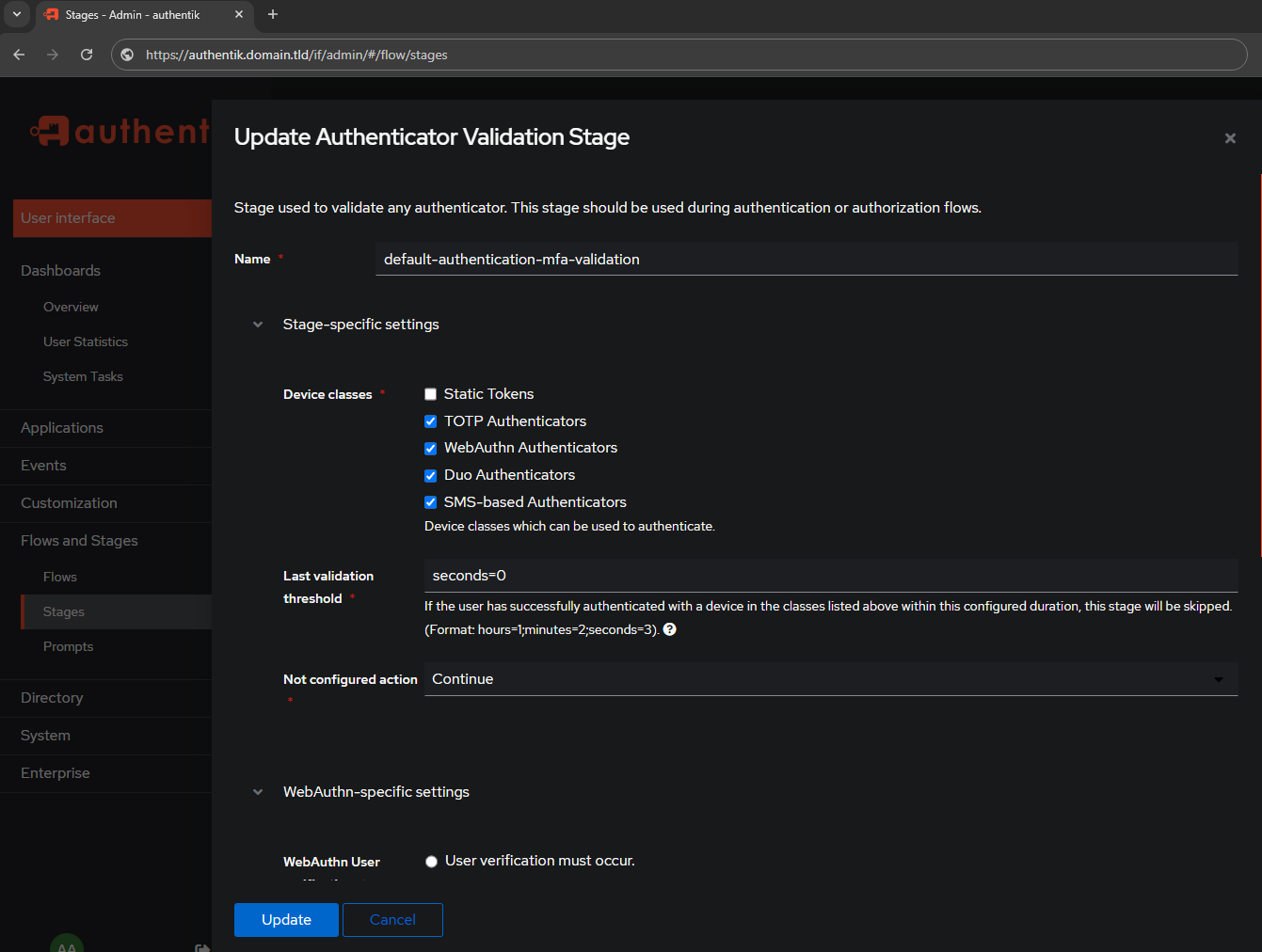

mfa-stage-defaults
Change the Device Classes to what options you want you or other users to have (by default). I am only going to REMOVE static tokens.
no-static

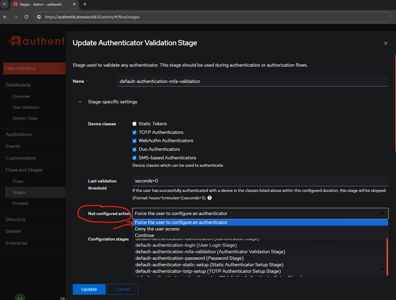

Modify the Not configured action to Force the user to configure an authenticator:
  • Default: Continue
  • Modified: Force the user to configure an authenticator
    force-mfa
After setting the Not configured action to Force the user to configure an authenticator it will unlock the Configuration stages options as seen above.
This section, as it says right below it
Stages used to configure Authenticator when user doesn't have any compatible devices. After this configuration Stage passes, the user is not prompted again.
When multiple stages are selected, the user can choose which one they want to enroll.
In order to highlight multiple, use the Shift key.
mfa-selections
Hit Update

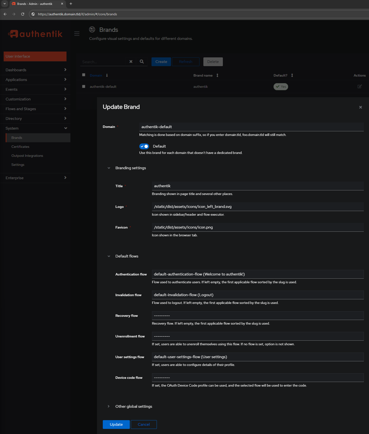

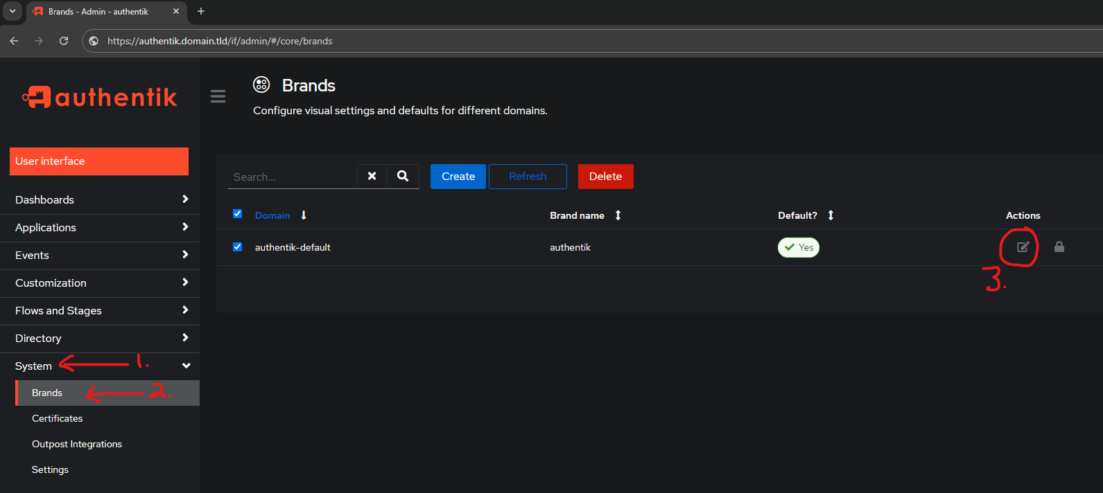

Domain Wide (Tenet) Policies
View the Default Flows by going to the Admin Interface
  1. System
  2. Brands
  3. Edit authentik-default
    domain-defaults
Expand down Default flows
def-flows
Notice that the DEFAULT Authentication flow is default-authentication-flow (Welcome to authentik!)
