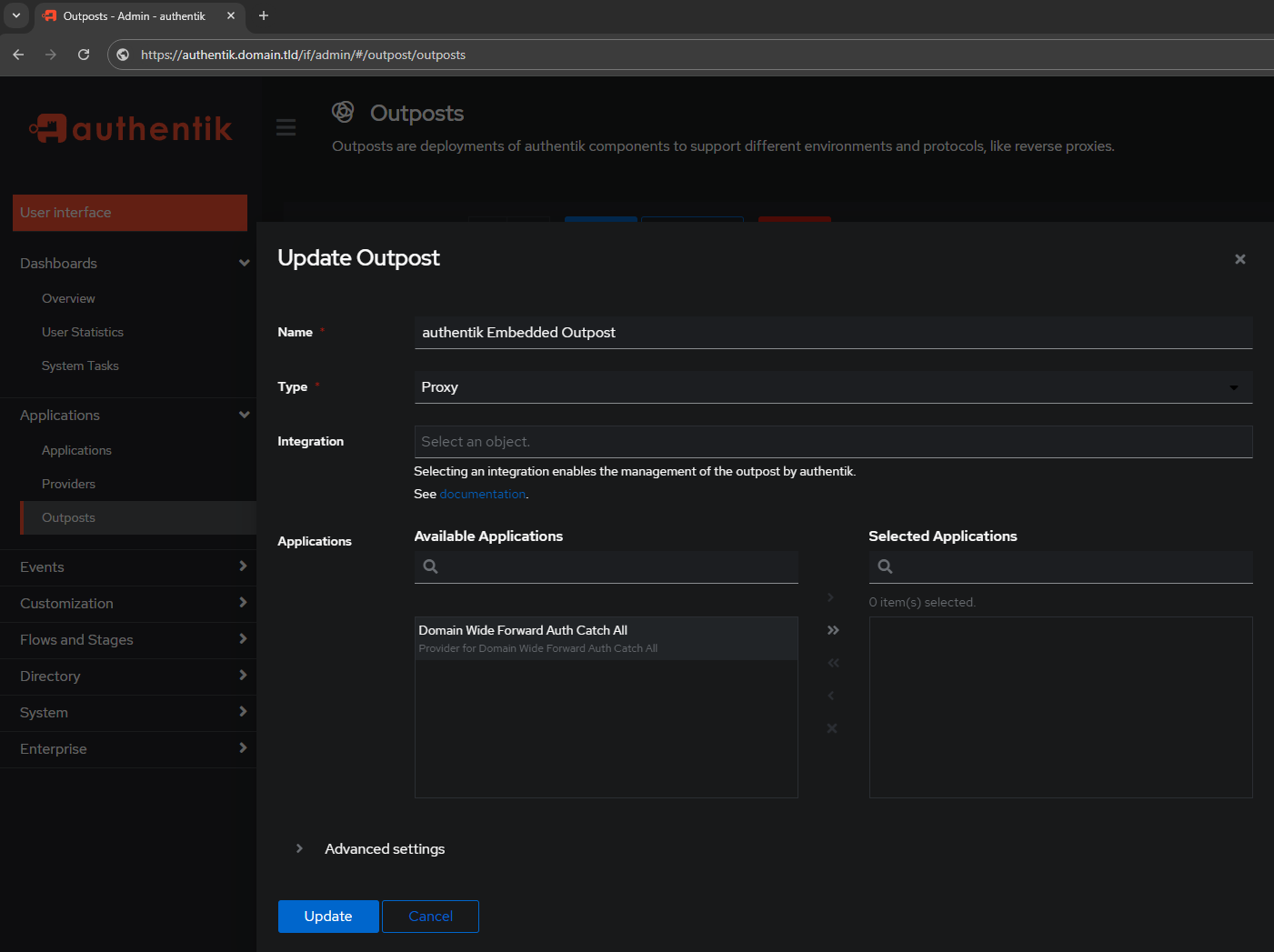

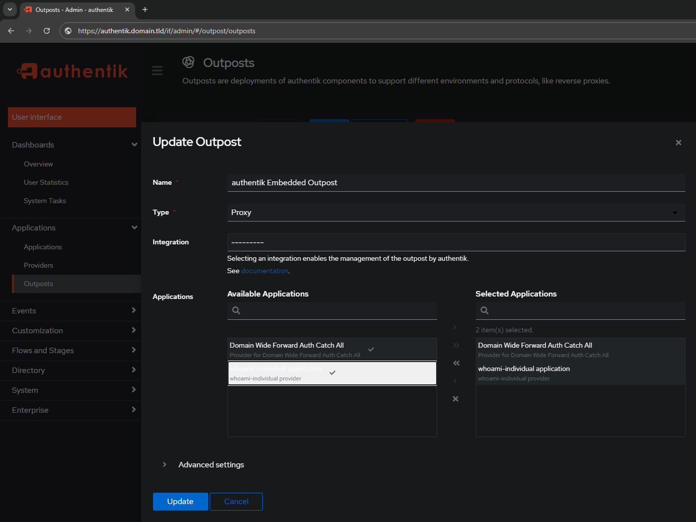

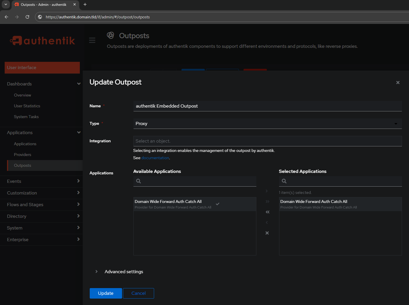

The one that makes Authentik work is
middlewares-authentik.yamlORforwardAuth-authentik.yaml. They are the exact same thing, but you can decide which name makes more sense to use. In thecompose.yamlI am usingmiddlewares-authentik, but to me it makes more sense to useforwardAuth-authentikso when you are reading the traefik label's you know what it is supposed to do. Your choice.

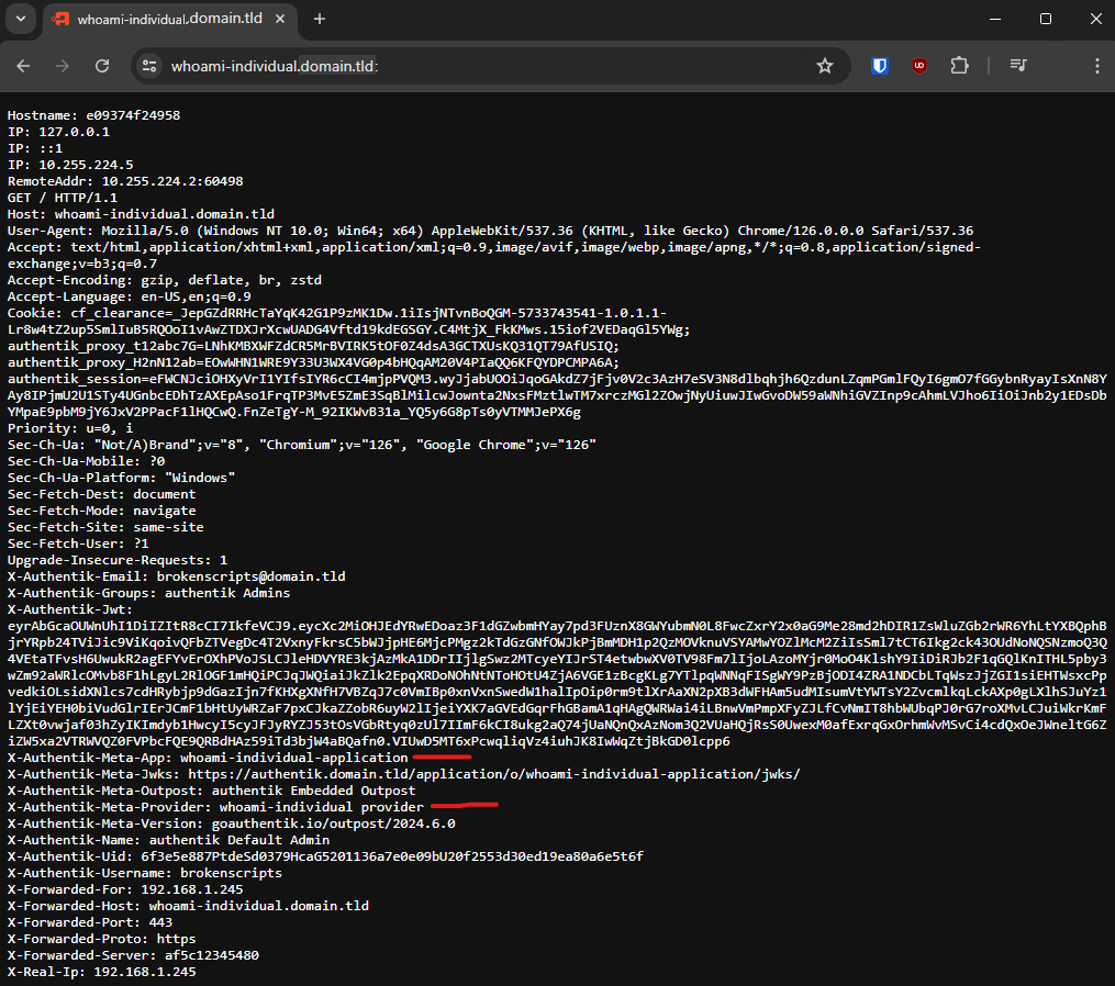

In order to setup forwardAuth at a minimum, Traefik requires a declaration. Authentik provides an example, but in accordance with the compose.yaml the values below should make more sense.
# Middlewares (https://github.com/htpcBeginner/docker-traefik/blob/master/appdata/traefik2/rules/cloudserver/middlewares.yml)
# 2024 update: https://github.com/htpcBeginner/docker-traefik/tree/master/appdata/traefik3/rules/hs
# https://www.smarthomebeginner.com/traefik-docker-compose-guide-2022/
# Dynamic configuration
http:
middlewares:
# Forward Authentication - OAUTH / 2FA
forwardAuth-authentik:
forwardAuth:
trustForwardHeader: true
authResponseHeaders:
- X-authentik-username
- X-authentik-groups
- X-authentik-email
- X-authentik-name
- X-authentik-uid
- X-authentik-jwt
- X-authentik-meta-jwks
- X-authentik-meta-outpost
- X-authentik-meta-provider
- X-authentik-meta-app
- X-authentik-meta-version

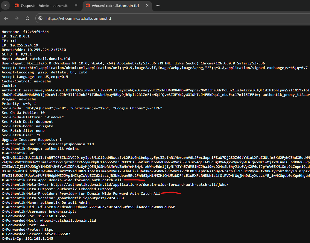

The Forward Authentication WILL NOT work unless the middleware is enabled.
Warning
"Priority based on rule length" Authentik generates the priority for authentication based on rule length (Traefik label). This means if you have a rule (Traefik label) for Authentik to listen on multiple host names with
OR, ||statements, it will have a higher priority than the embedded outpost. Refer to goauthentik/authentik#2180 about setting the priority for the embedded outpost.

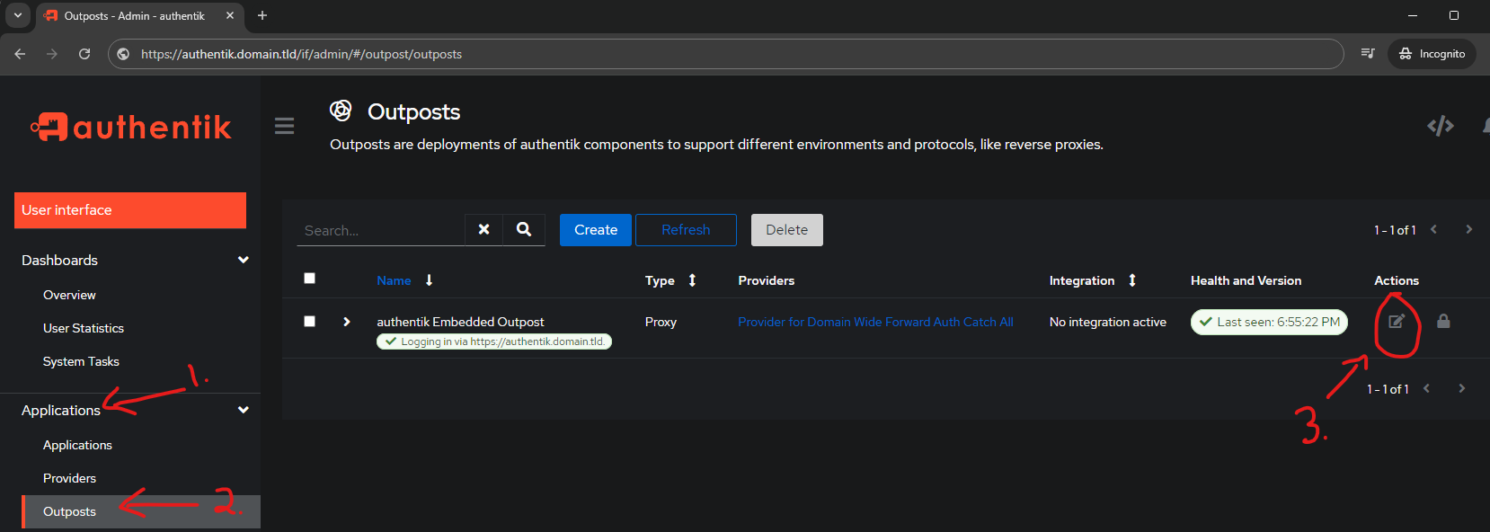

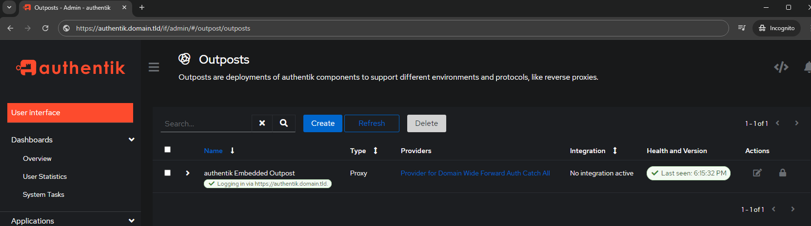

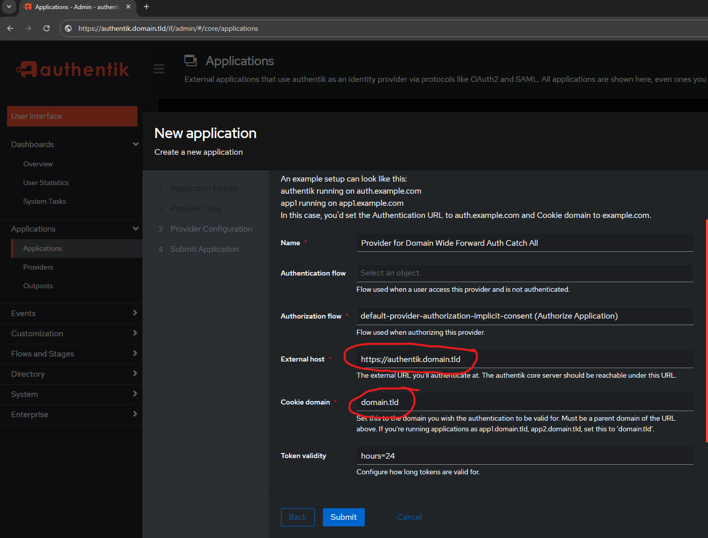

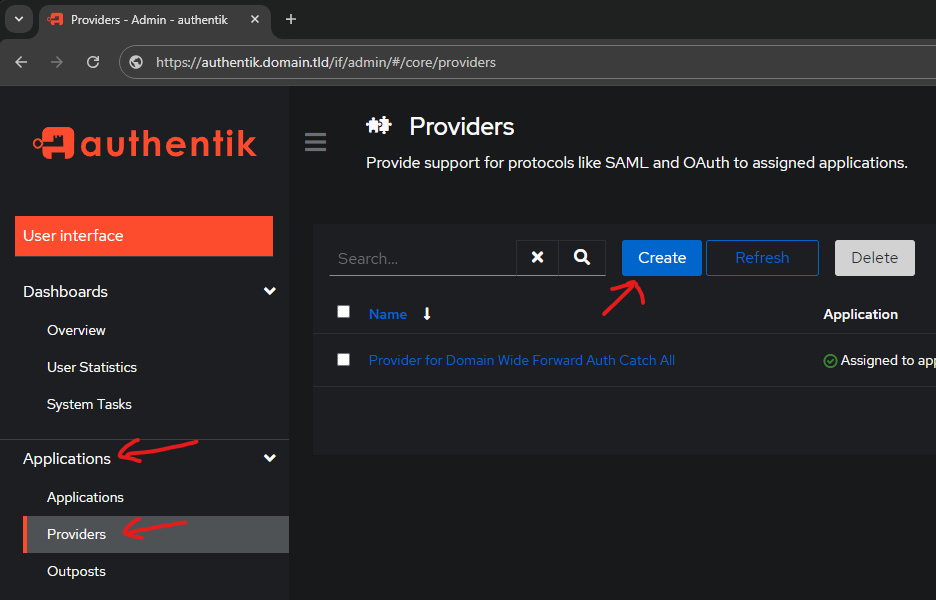

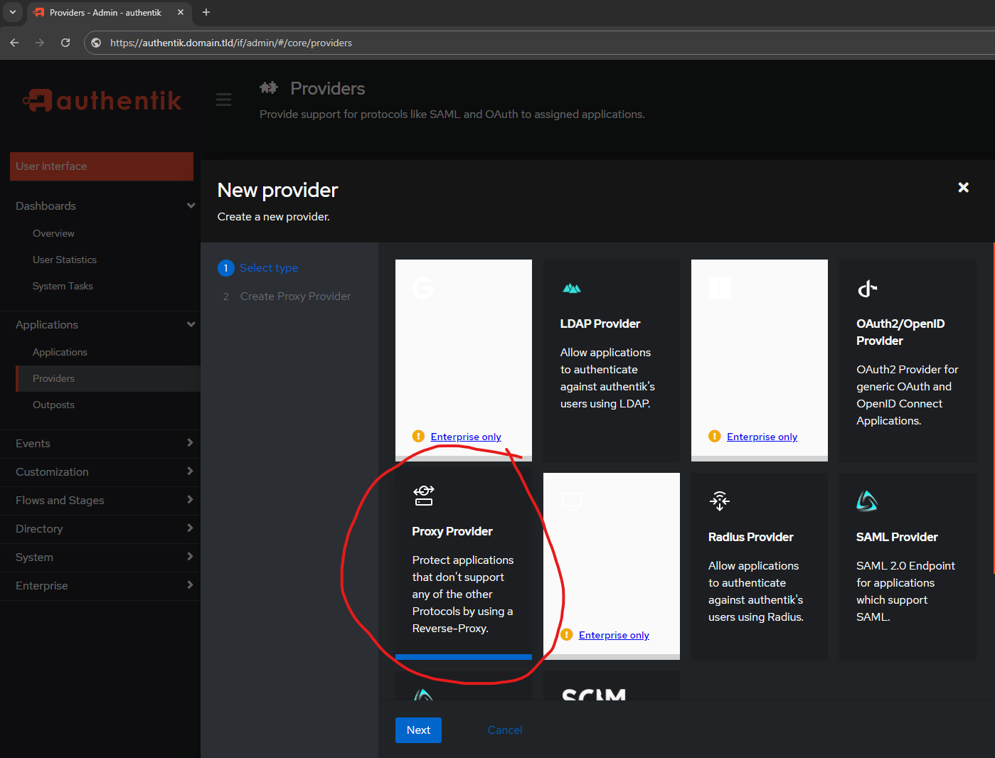

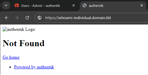

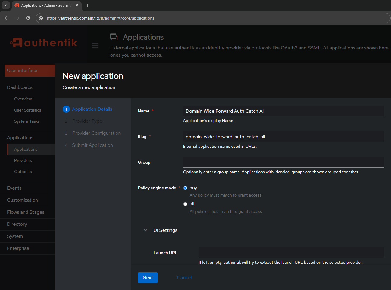

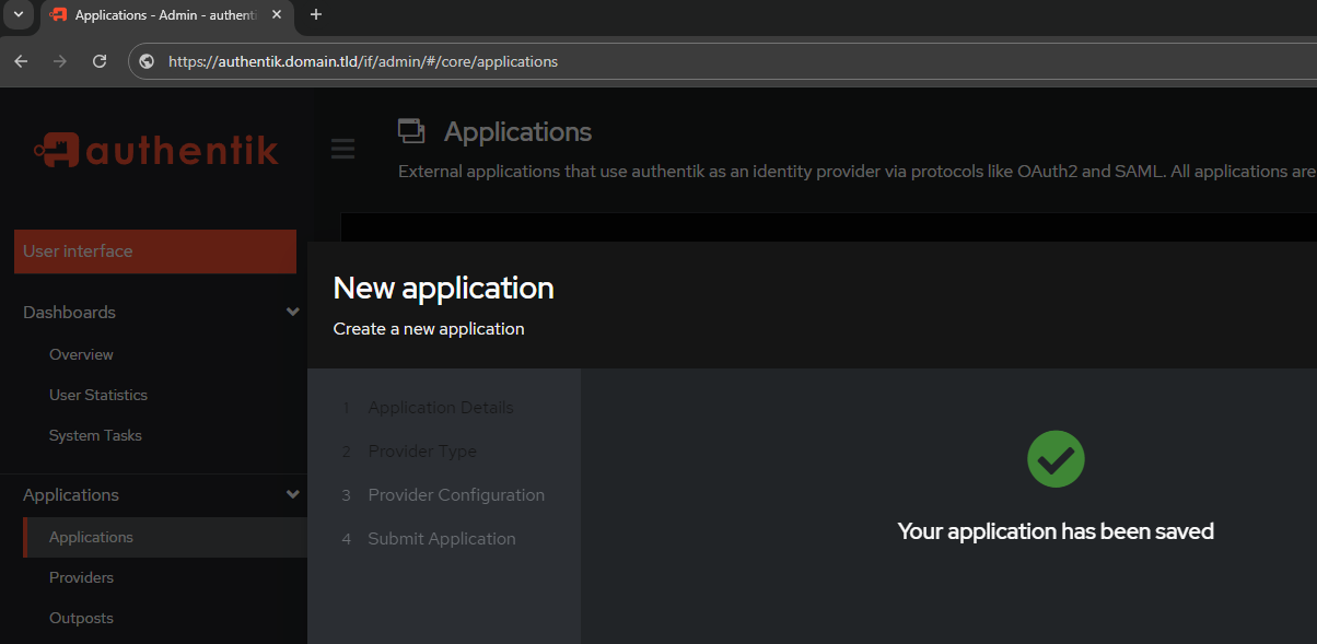

Authentik Setup
Because Authentik uses cookies, I recommend using Incognito for each piece of testing, so you don't have to clear cookies every time or when something is setup incorrectly.
Warning
While using a container behind Authentik, it prompts for authentication, and then flashes but doesn't load. This generally indicates cookies are messing up the loading. So use INCOGNITO.

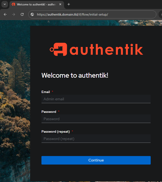

Initial Setup
- Navigate to Authentik at
https://authentik.domain.tld/if/flow/initial-setup/ - Login to Authentik to begin setup.
Note
If this is the first time logging in you will have to set the password for
akadmin(default user). If establishing the default credentials fails - the setup is not working correctly.
The default user is akadmin, which is a super user. This initial setup will setup the Super User's email and Password. You will change the username FROM akadmin to whatever you want.
The first screen you'll see after setting the password and email is:

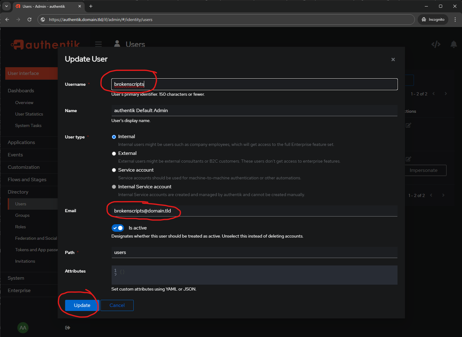

You can change the username from akadmin to whatever.

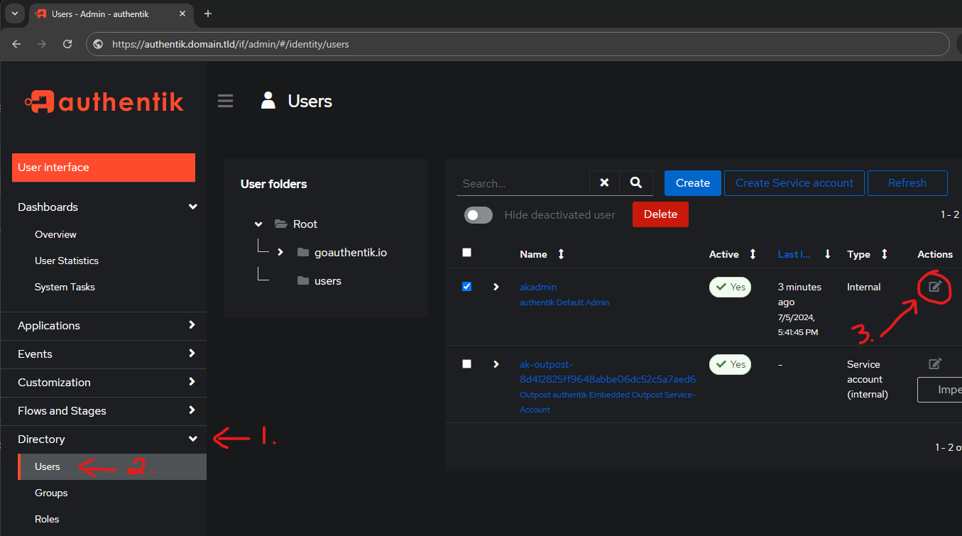

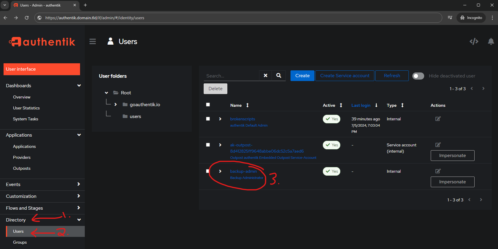

In the Admin Interface go to
- Directory
- Users
- Click on Edit beside
akadmin
(Information) Error Screen before Provider and Application
I think this is important for anyone that attempts to set this up.
If you attempt to navigate to a page that IS using Authentik's forwardAuth middleware but haven't finished setting up a provider and application (individual or domain wide catch all) then you will see a screen like this:

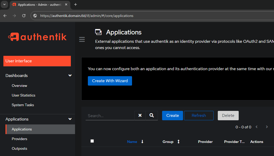

Applications / Providers
In the current version, for this documentation 2024.6.0, Authentik now includes a Wizard to aid with setting up a Application and Provider instead of manually doing it.
I am going to set up my Individual Application using the Wizard and the Domain Wide / Catch All manually. ONLY to show how you can do either method, both work!
Note
I am using the embedded outpost. The embedded outpost requires version
2021.8.1or newer. This prevents needing the seperate Forward Auth / Proxy Provider container.
Domain Wide / Catch All (forwardAuth) using the Wizard
In order for this to "Catch All" you must set a traefik middleware on each service. Look inside the compose.yaml. This specific snippet is from the whoami-individual service inside the authentik/compose.yaml:
Specifically the middlewares-authentik@file" line.
labels:
- "traefik.enable=true"
## HTTP Routers
- "traefik.http.routers.whoami-individual-rtr.rule=Host(`whoami-individual.${DOMAINNAME}`)"
## Middlewares
- "traefik.http.routers.whoami-individual-rtr.middlewares=middlewares-authentik@file"
Navigate to:
Wizard Page 1 - "Application Details"
- Name:
Domain Wide Forward Auth Catch All - Slug:
domain-wide-forward-auth-catch-all - Group:
empty - Policy Engine Mode:
any - UI Settings:
- Launch URL:
empty
Do NOT put anything in the Launch URL, it needs to autodetect since it's the catch all rule - Open in new tab:
unchecked
- Launch URL:

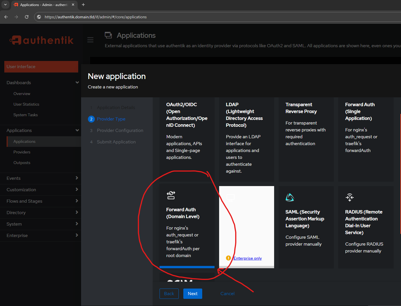

Wizard Page 2 - "Provider Type"
- Forward Auth (Domain Level)
Notice the blue highlight underneath showing the selection!
Wizard Page 3 - "Provider Configuration"
- Name:
Provider for Domain Wide Forward Auth Catch All - Authentication Flow:
empty
This is user choice, I recommend getting the basics setup and THEN modifying authentication flow for the catch all - Authorization Flow:
default-provider-authorization-explicit-consent (Authorize Application)
Explicit requires user interaction aka clicking a button to continue versus implicit which is just trust - External Host:
https://authentik.domain.tld - Cookie Domain:
domain.tld - Token Validity:
hours=24
When all is done, you should have success. If not, carefully review the previous settings. You most likely forgot https:// in front of authentik.domain.tld
Embedded Outpost (Domain Wide)

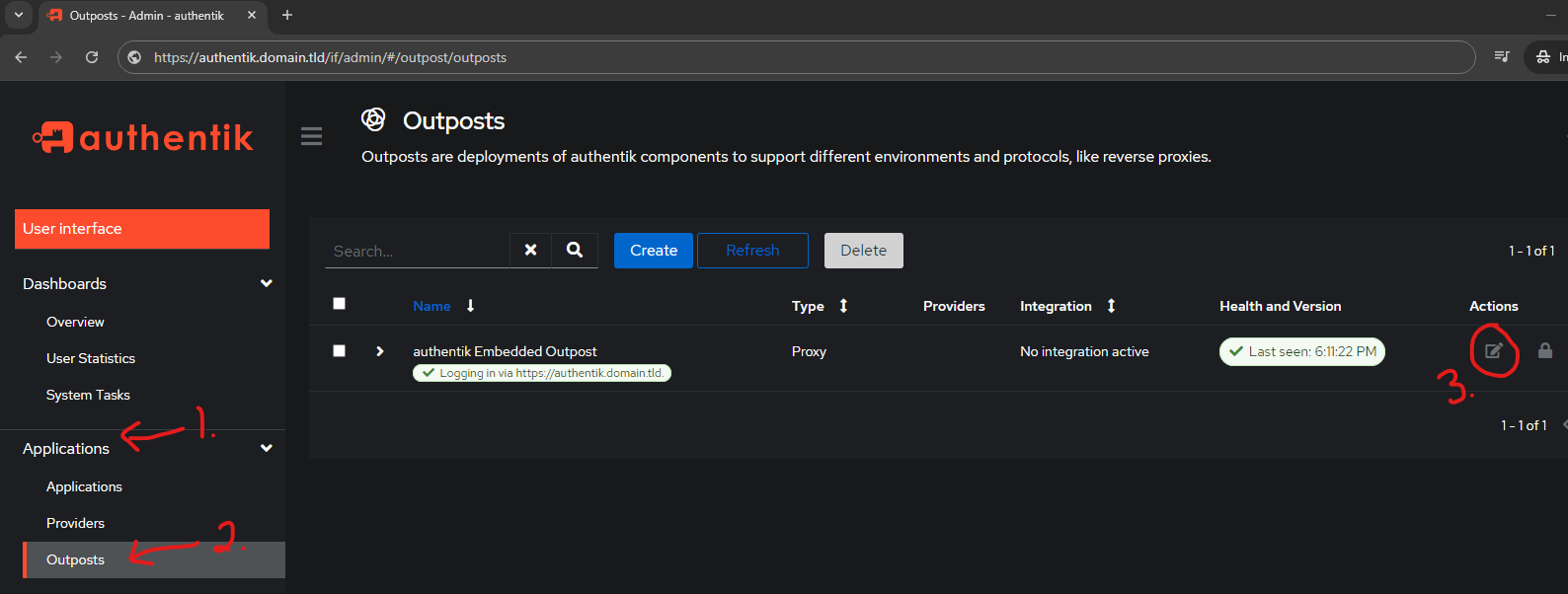

Navigate to the Outposts screen and edit the Embedded Outpost:
- Applications
- Outposts
- Edit the Embedded Outpost
Notice how the above picture has Providers empty?
Update the Outpost to have the Domain Wide Forward Auth Catch All in Selected Applications
Now the Embedded Outpost shows the Provider for the Catch All rule instead of it being empty/blank:
Domain Wide / Catch All Test/Validation
Now that the catch all rule is in place, validate it using the already running whoami-catchall container created:
Navigate to whoami-catchall.domain.tld and it will immediately redirect you to Authentik to login:
X-Authentik-Meta-App: domain-wide-forward-auth-catch-all

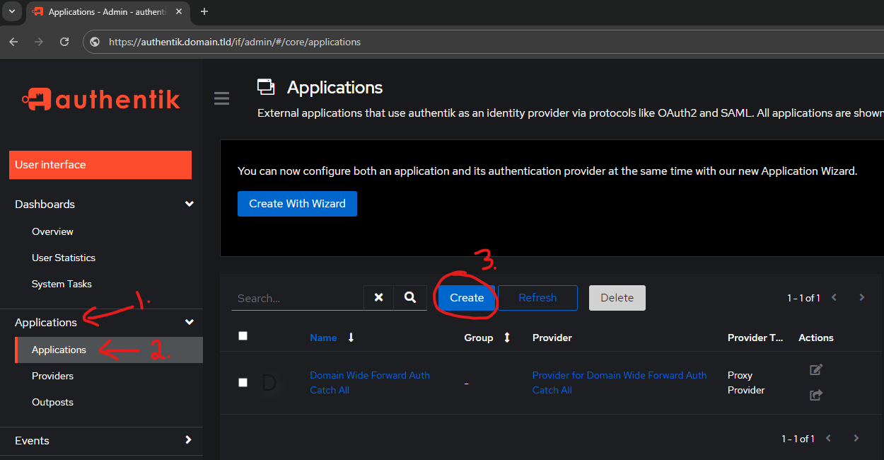

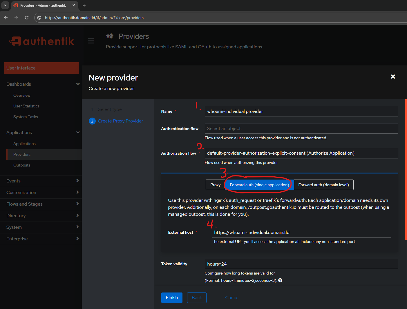

Provider Creation (Individual Application) - Manual
In the Admin Interface, go to:
2. Applications
3. Providers
4. Create
Use the following settings:
- Name:
whoami-individual provider - Authentication Flow:
empty
default-provider-authorization-explicit-consent (Authorize Application) - Type:
Forward auth (single application)
Single Application is where we change it up! - External Host:
https://whoami-individual.domain.tld - Token Validity:
hours=24

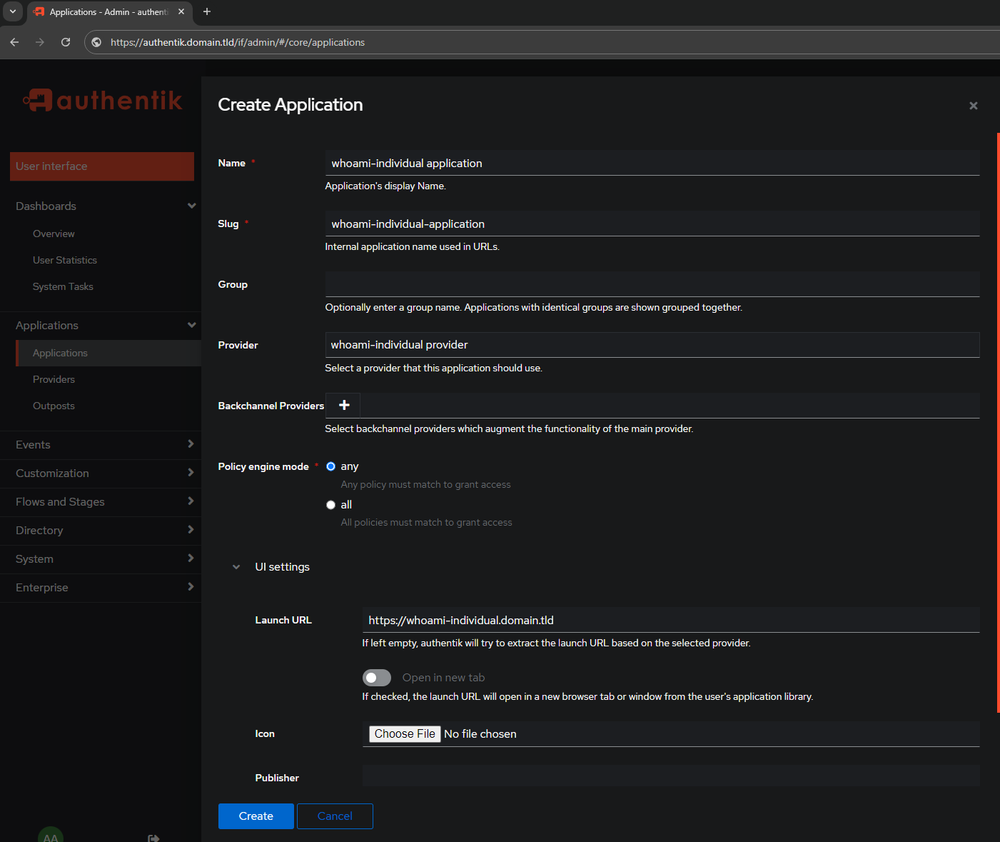

Application Creation (Individual Application) - Manual
- Applications
- Applications
- Create
- Name:
whoami-individual application - Slug:
whoami-individual-application - Group:
empty - Provider:
This is where you bind it to the previously created provider! - Backchannel Providers:
any - UI Settings
- Launch URL:
Since this is an individual application, specify where it is found at
- Launch URL:

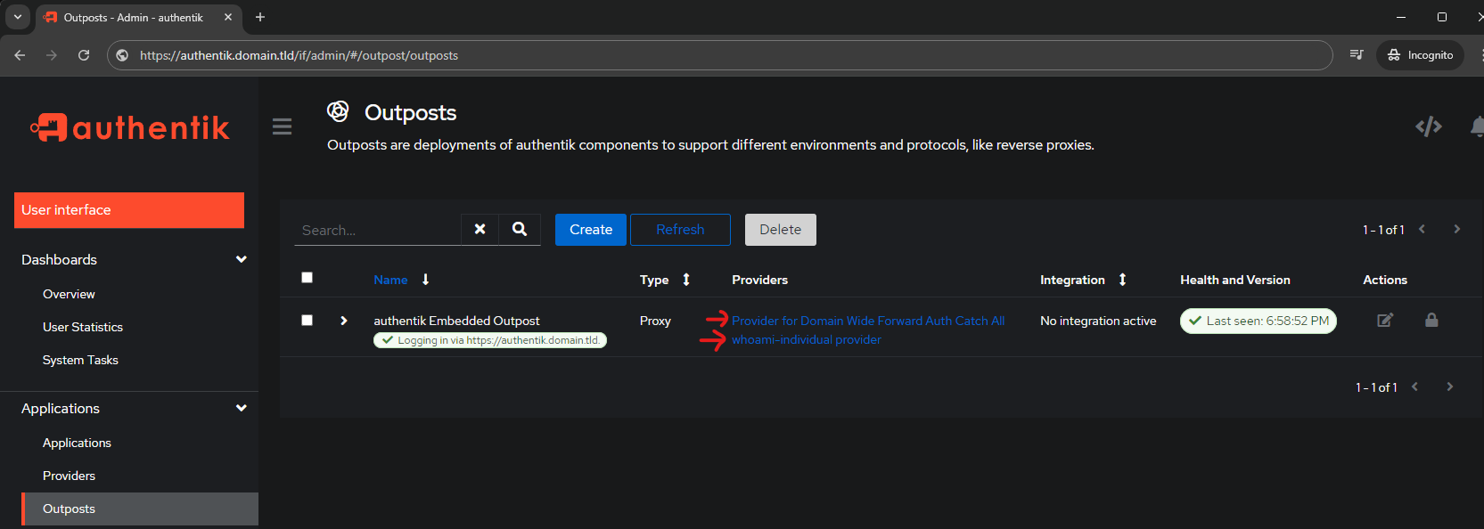

Embedded Outpost (Individual Application)
- Applications
- Outposts
Highlight any application you want the outpost to be able to provide for. In this case Highlight whoami-individual application
BEFORE HIGHLIGHT
Notice that BEFORE highlighting and adding to Selected Applications, it still has only the Domain Wide Forward Auth Catch All rule in Selected Applications:
AFTER HIGHLIGHT
After hitting Update the Outpost page will show that the embedded outpost now has both providers bound to it:

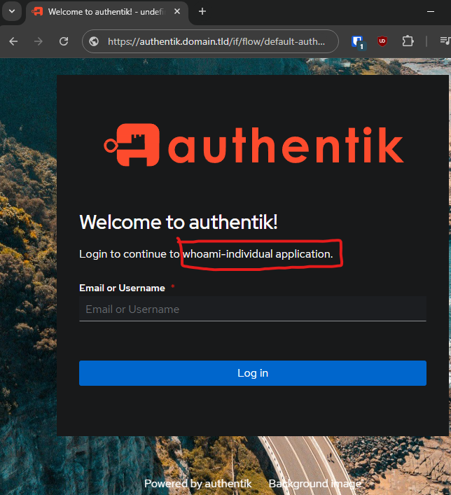

Individual Application Test/Validation
Now that the individual application rule is in place, validate it using the already running whoami-individual container created:
Navigate to whoami-individual.domain.tld and it will immediately redirect you to Authentik to login:
X-Authentik-Meta-App: whoami-individual-application

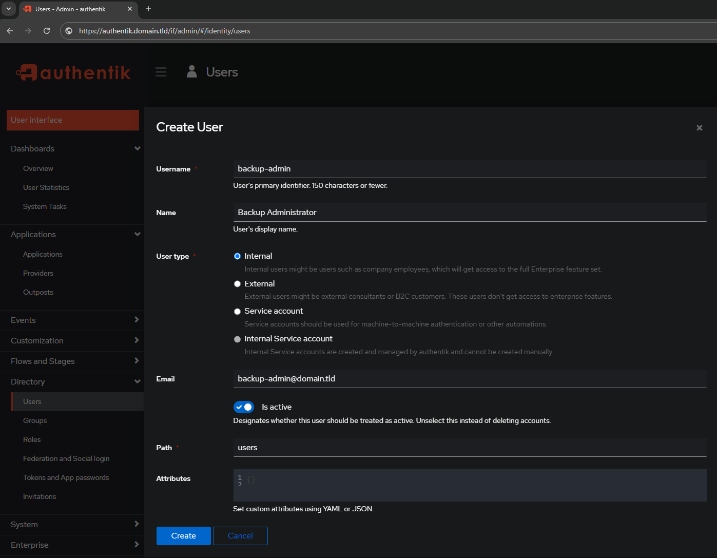

(Optional) New User Creation
- Directory
- Users
- Create
Fill in the required information:

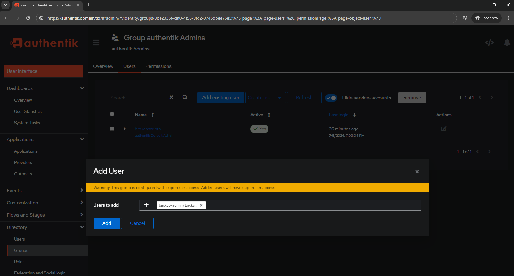

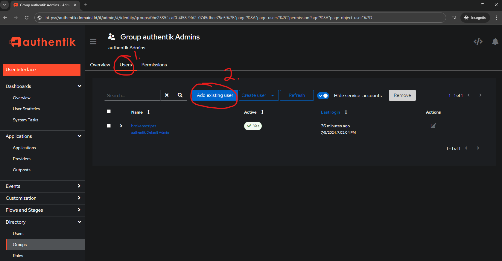

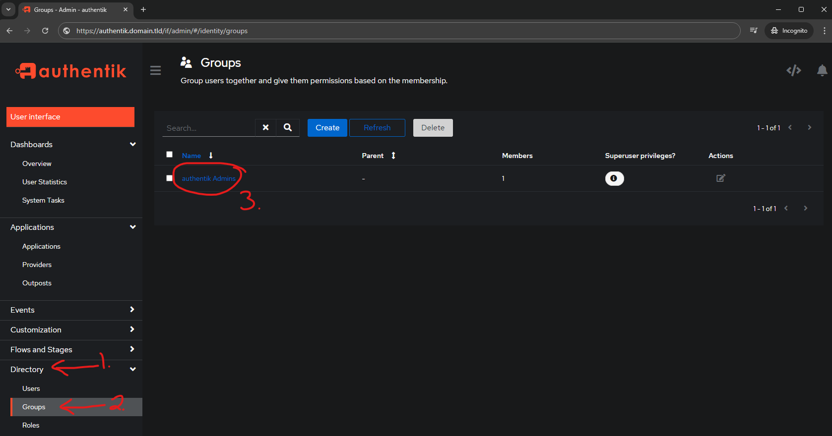

(Optional) Add user to Administrator/Superuser Group
Inside the Admin Interface do the following steps to add a user to the Admins group:
- Directory
- Groups
- Left click/Open
authentik Admins
Next, add an existing user to the Users tab:
- Users
- Add existing user

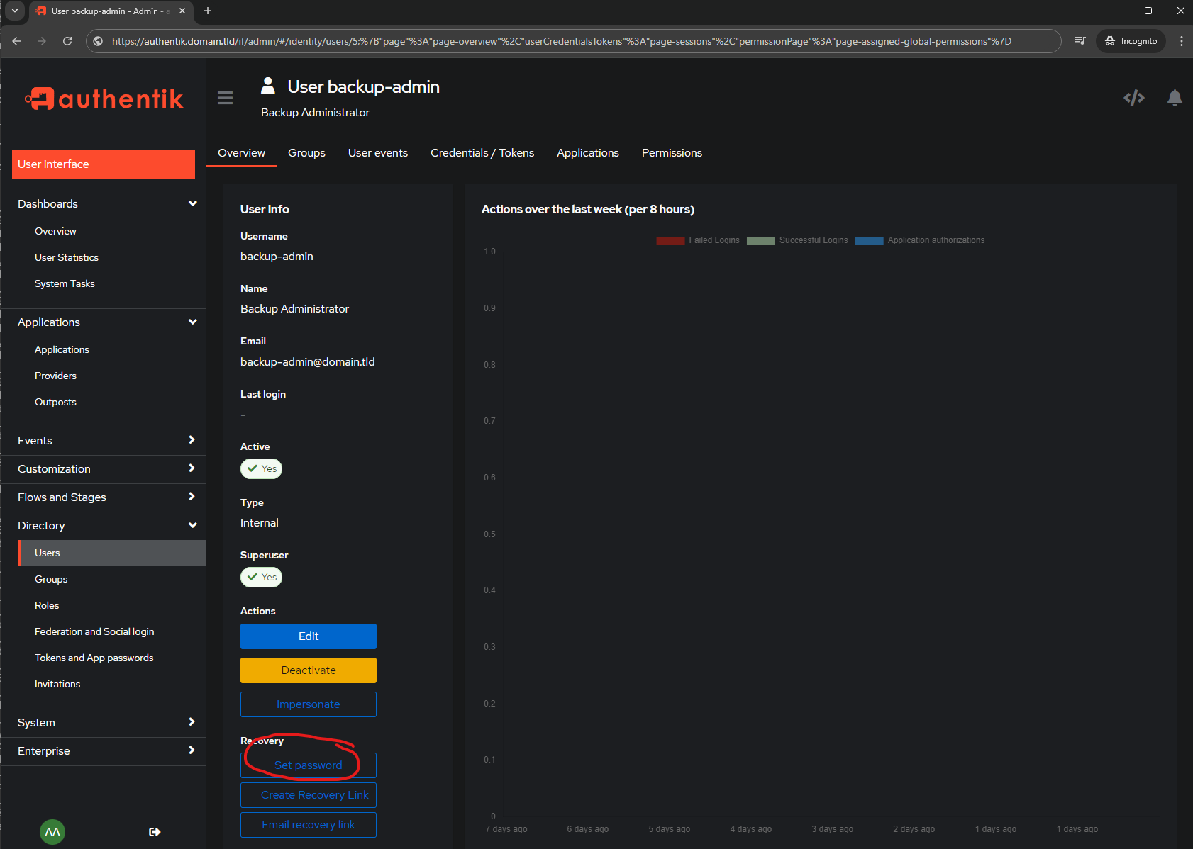

(Optional) Change user password
Inside the Admin Interface do the following:
- Directory
- Users
- Left click/Open the specific user

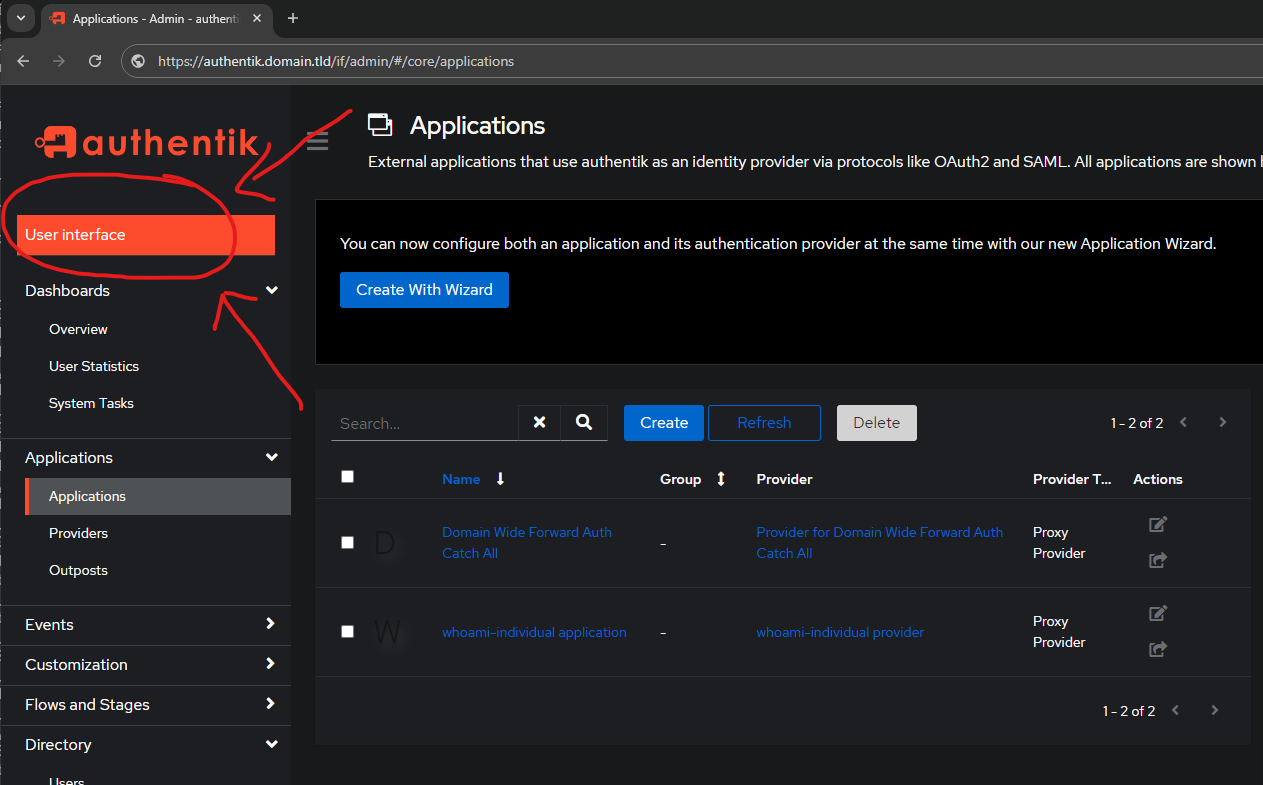

Recommended to Switch to standard browser / NOT Incognito.

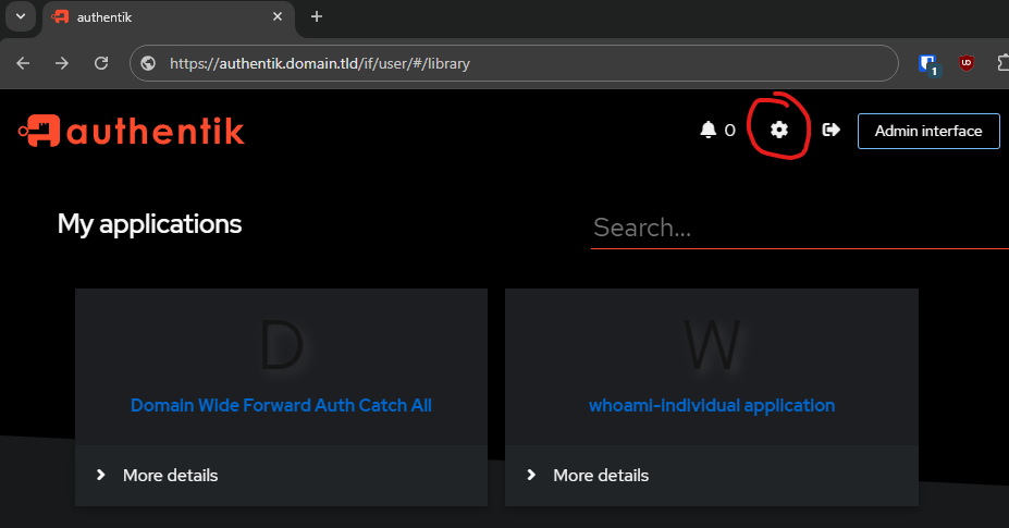

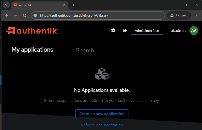

IF you are in the Admin Interface navigate to the User Interface via the button at the top left:

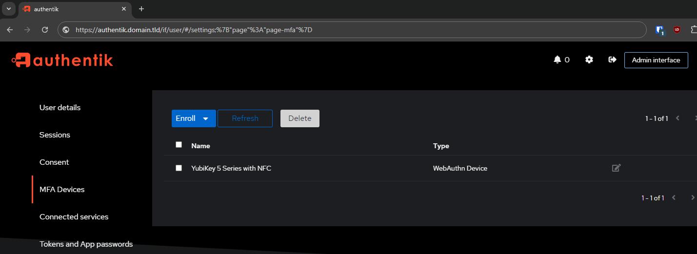

Navigate to the MFA Devices screen:
- Settings
- MFA Devices
- Enroll
- WebAuthn device

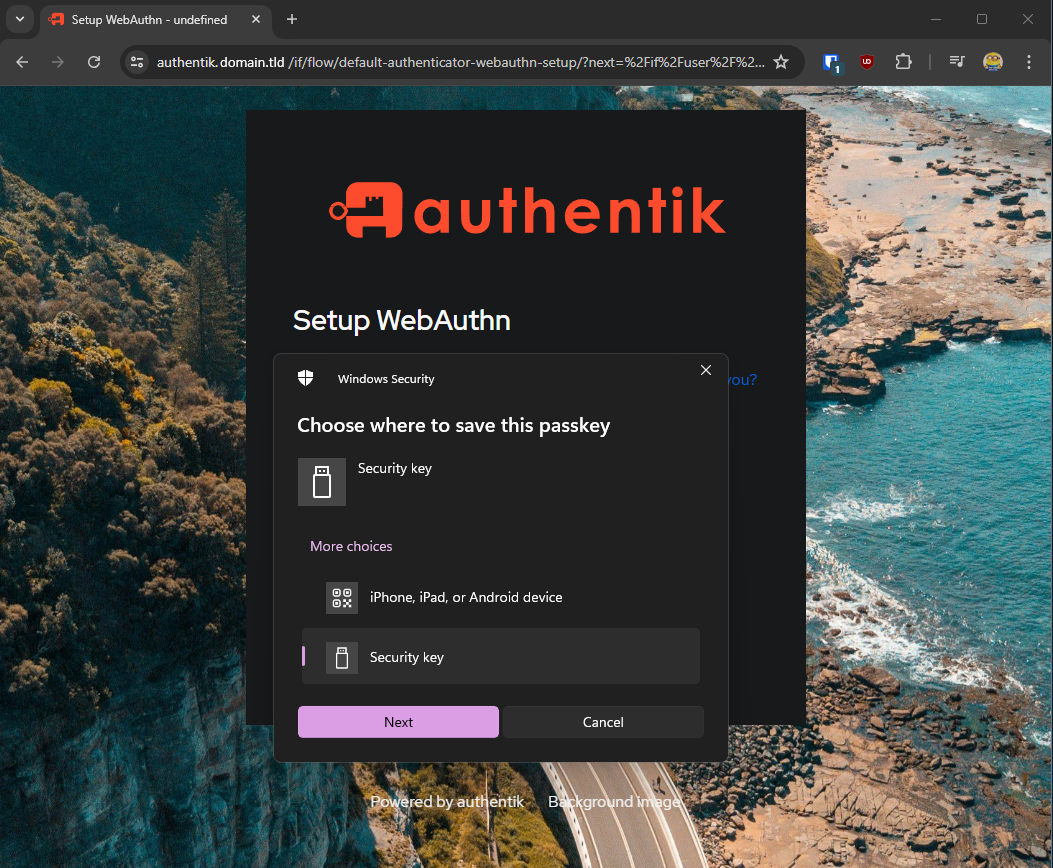

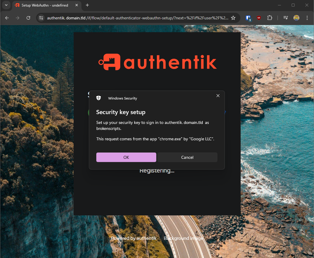

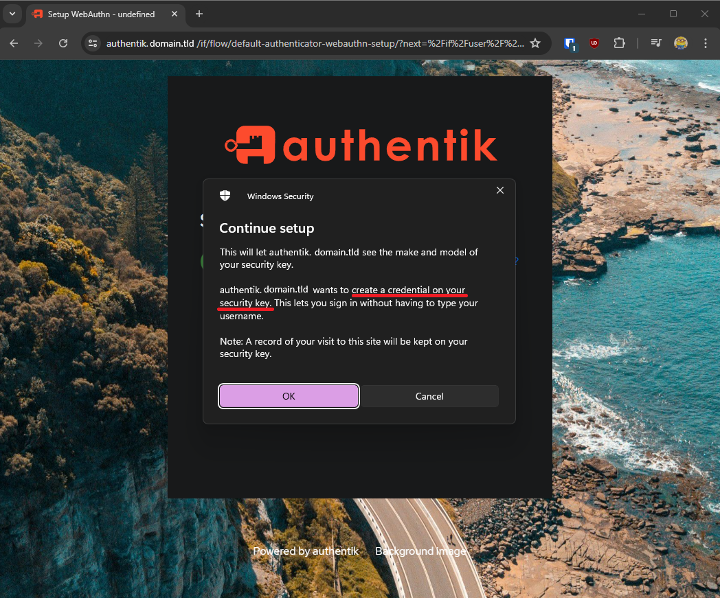

Enrollment with Credential on Key
Now complete the WebAuthn Setup:
Hit next and you'll see that you are about to setup your key:
Caution
By performing the setup like this, it asks to create a credential on the Yubikey device itself. If you want to make it where it does NOT create the credential itself skip setup for now and go to the
Modify WebAuthn Credential Creation Locationsection where I will show how to change the save credential to key option. After changing that option, you can revisit setup.
STOP - Read the Above Caution Statement before continuing!
If you're ok with creating the credential on your key, continue!

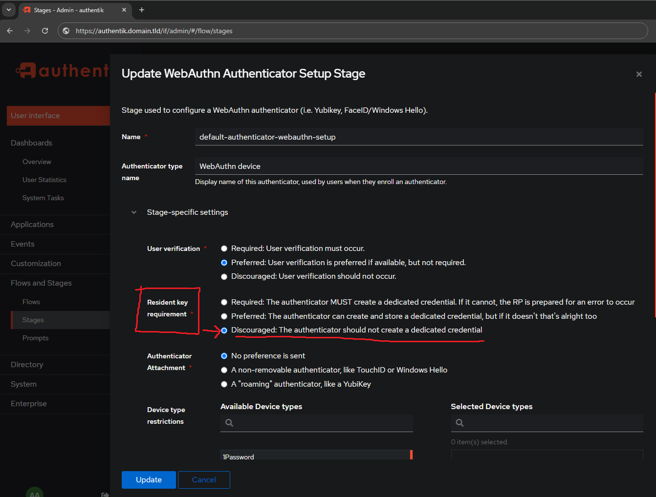

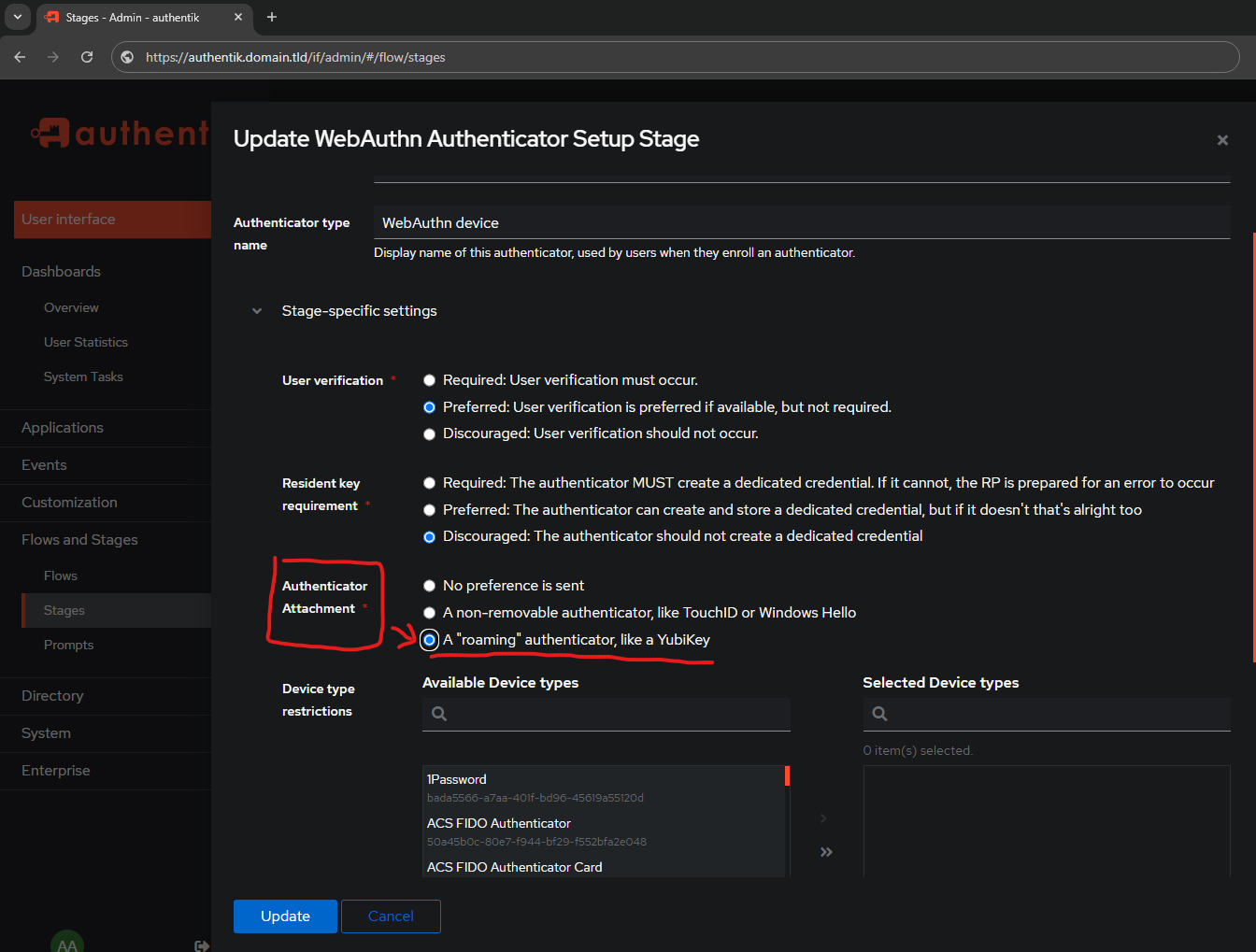

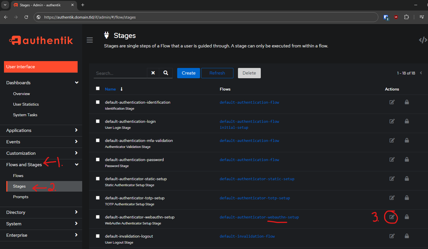

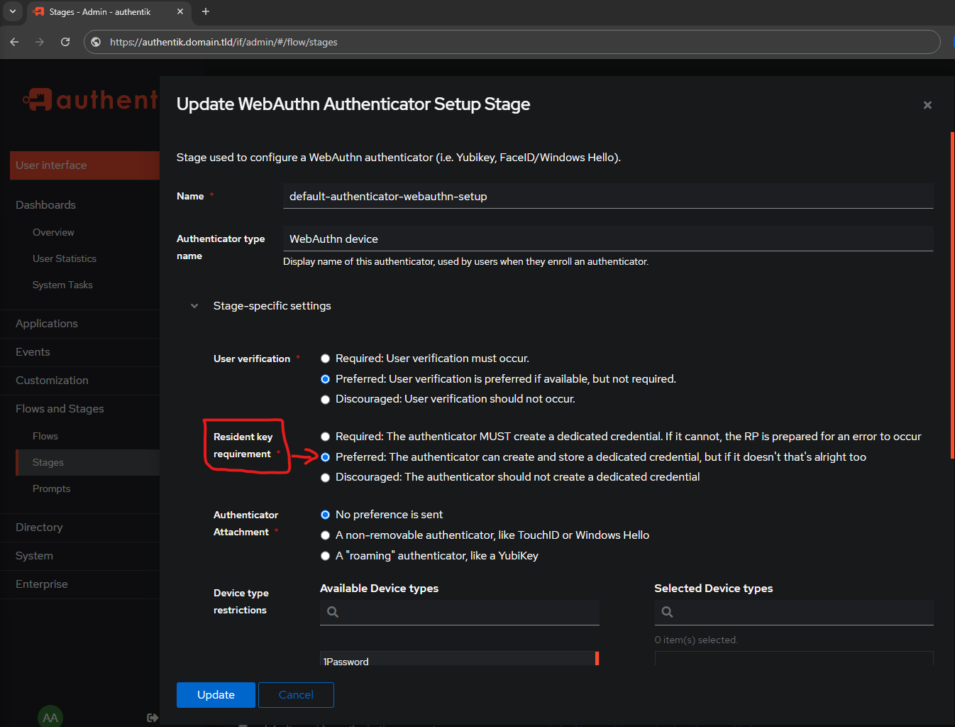

- Go to the Admin Interface
- Flows and Stages
- Stages
- Edit
default-authenticator-webauthn-setup
Edit the Resident key requirement
- Default:
Preferred: The authenticator can create and store a dedicated credential, but if it doesn't that's alright too
Unfortunately, if I try to skip the dedicated credential, I am unable to setup a Yubikey. I am going to set this option to:
- Modified:
Discouraged: The authenticator should not create a dedicated credential
(Optional) Edit the User verification depending on your WebAuthn expertise.
I am leaving it default:
- Default:
Preferred: User verification is preferred if available, but not required
(Optional) Authenticator preference
Authentik by default has no preference set for the Authenticator, as shown in the above picture. This can be changed to be explicitly Yubikey OR Windows Hello/TouchID. If you do not want to be prompted by Windows Hello, as shown in the Windows Hello section, then set this to A "roaming" authenticator, like a YubiKey.

(Troubleshooting) Windows Hello
Press ESC to continue to actual Yubikey enrollment. This only seems to happen if you have previously setup Windows Hello.
Note
If you are prompted for a PIN that you do not know, go to the
Enrollment with Credential on Keysection for the Yubikey documentation link to address the PIN. Optionally, you can also Force it to skip Windows Hello and go straight to the Yubikey by modifying thedefault-authenticator-webauthn-setup, as seen in the(Optional) Authenticator preferencesection above.

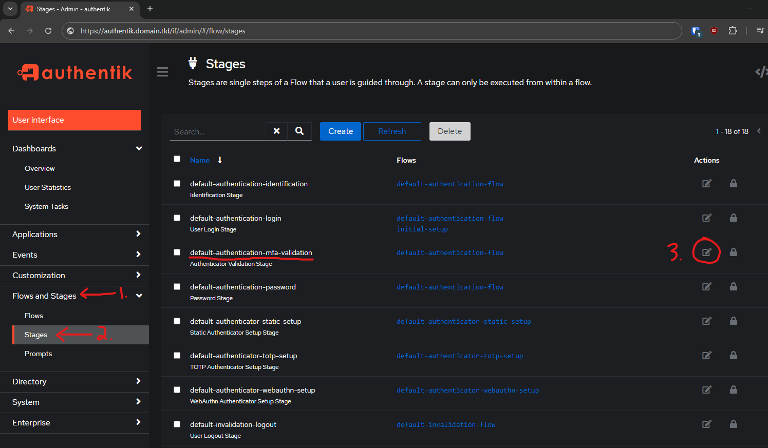

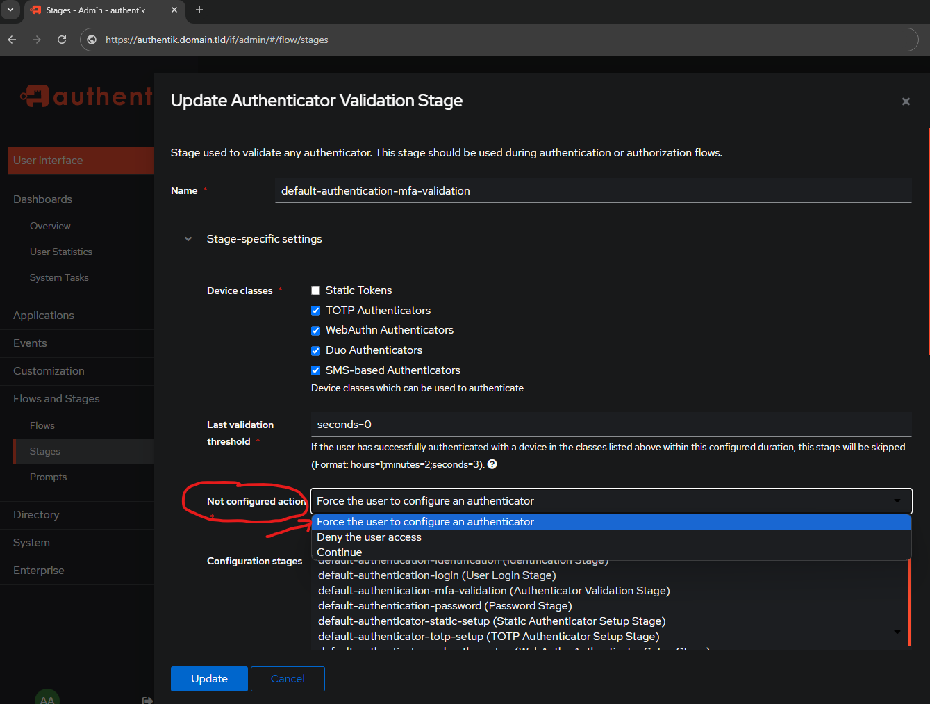

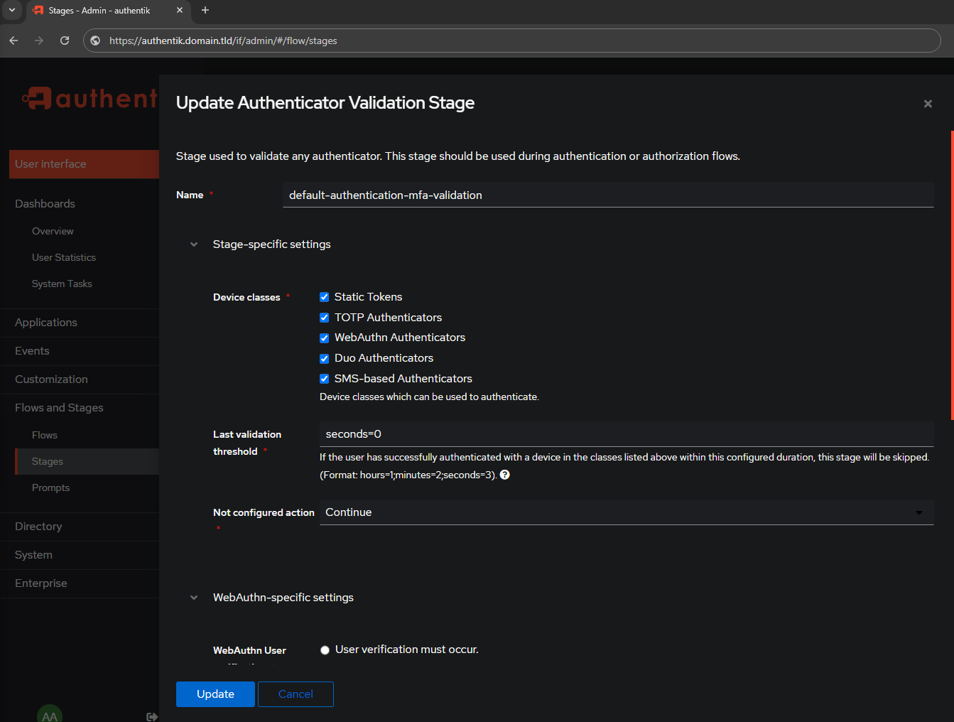

(Optional) Force Multi-Factor Authentication (MFA)
- Flows & Stages
- Stages
- Edit
default-authentication-mfa-validation
Change the Device Classes to what options you want you or other users to have (by default). I am only going to REMOVE static tokens.
Modify the Not configured action to Force the user to configure an authenticator:
After setting the Not configured action to Force the user to configure an authenticator it will unlock the Configuration stages options as seen above.
This section, as it says right below it
Stages used to configure Authenticator when user doesn't have any compatible devices. After this configuration Stage passes, the user is not prompted again.
When multiple stages are selected, the user can choose which one they want to enroll.
- Select:
default-authenticator-totp-setup (TOP Authenticator Setup Stage) - Select:
default-authenticator-webauthn-setup (WebAuthn Authenticator Setup Stage)
In order to highlight multiple, use the Shift key.
Hit Update

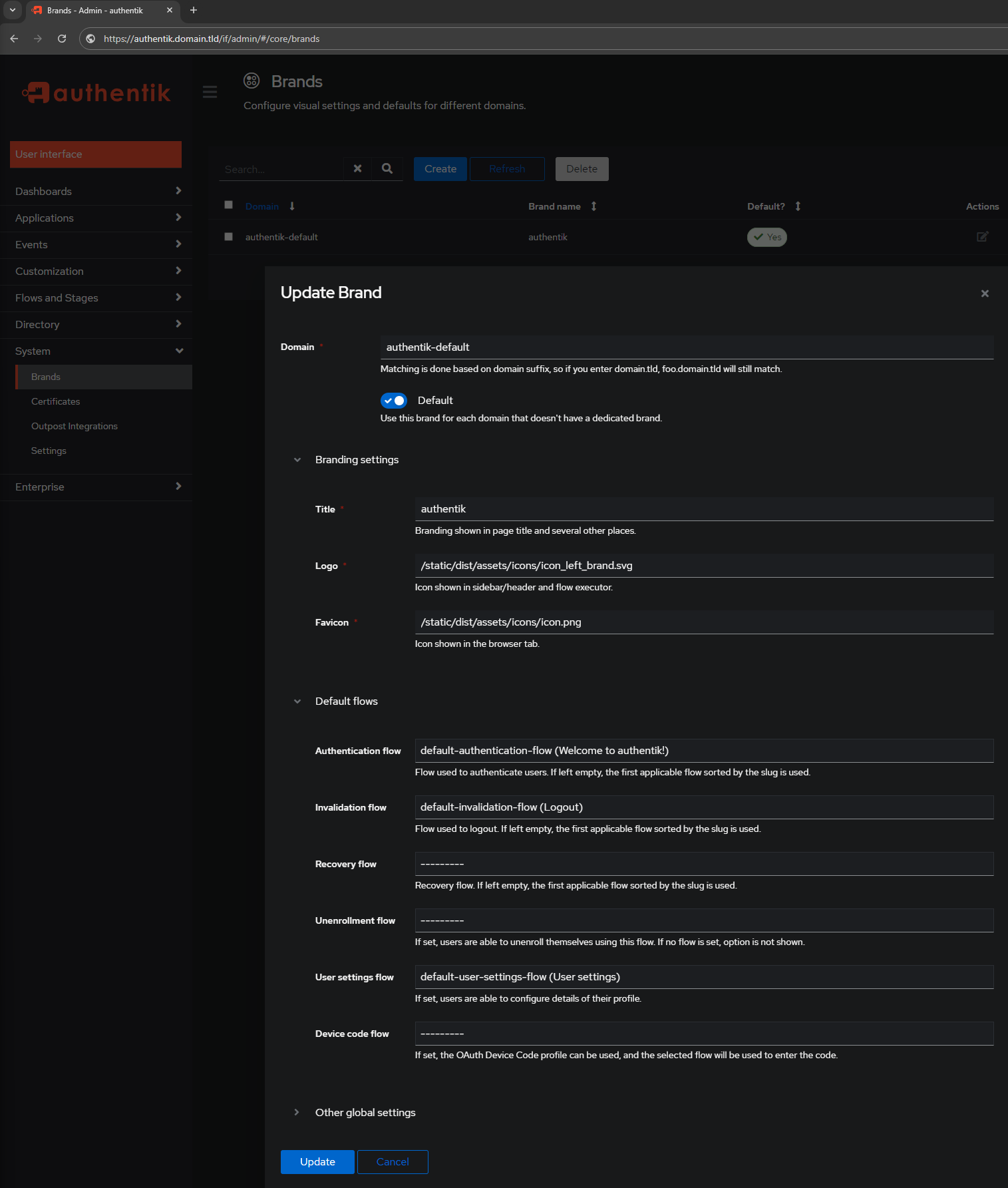

View the Default Flows by going to the Admin Interface
Notice that the DEFAULT Authentication flow is default-authentication-flow (Welcome to authentik!)
Navigate to:
- Flows and Stages
- Flows
In order to view the default default-authentication-flow.
Why does this matter? To understand the way YOU have this identity tool setup.
