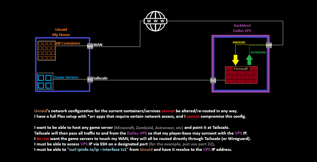

Before starting, ensure you have:
- An Unraid server
- A VPS
- Tailscale installed on both Unraid and VPS
- Root/sudo access on both machines
- Basic command line knowledge

Modify these variables in the script:
VPS_IP="your.vps.ip.address" Use the public IP address of your VPS (not the Tailscale IP) GAME_SUBNET="172.16.0.0/24" # Adjust if your subnet is different [Use the subnet where your game server containers are running in Unraid (typically your Docker network subnet, which you can find in Unraid's Docker settings)] -

For these variables:UNRAID_TAILSCALE_IP="your.unraid.tailscale.ip" WAN_INTERFACE="eth0" # Change if your interface is different
UNRAID_TAILSCALE_IP = Use your Unraid's Tailscale IP (get it by running tailscale ip -4 on Unraid)
WAN_INTERFACE = This is your VPS's main network interface, usually eth0 (verify with ip a on VPS)
Example:
UNRAID_TAILSCALE_IP="100.x.y.z" # Your Unraid's Tailscale IP
WAN_INTERFACE="eth0" # Usually eth0 on most VPS providers
To quickly get your Unraid's Tailscale IP, SSH into Unraid and run:
